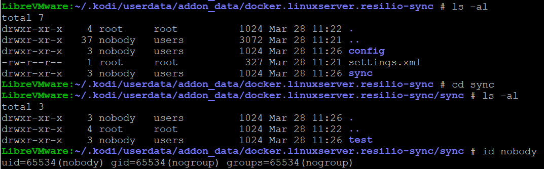

    I talked to the team members and they let me know that everything resides inside "/sync" inside the container, which is by default mapped to "/storage/.kodi/userdata/addon_data/docker.linuxserver.resilio-sync/sync" on libreelec. But you can change that in the addon settings.
    The resilio-sync client runs as user nobody (65534) so all the files in that sync folder should be owned by that.

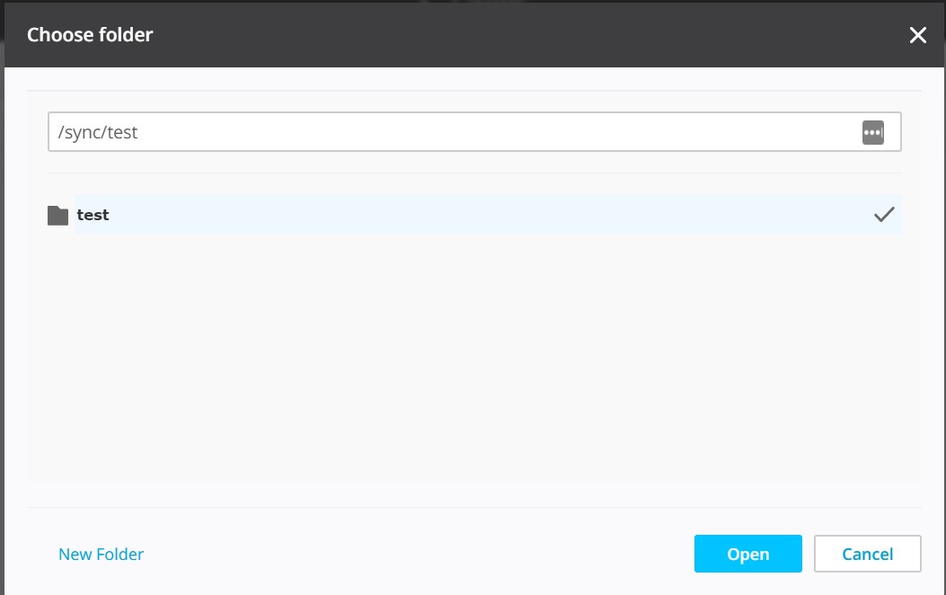

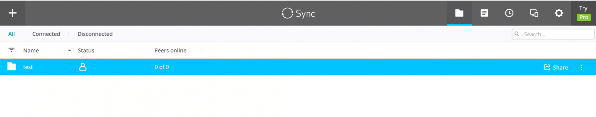

    I set up a fresh resilio-sync addon on my libreelec vm and I can go to add folder (standard), hit "new folder" and create one. All those newly created folders are under "/sync". I didn't have any issues.
    The addon creates those folders and changes ownership to user nobody on start.
    See the attached screenshots.
