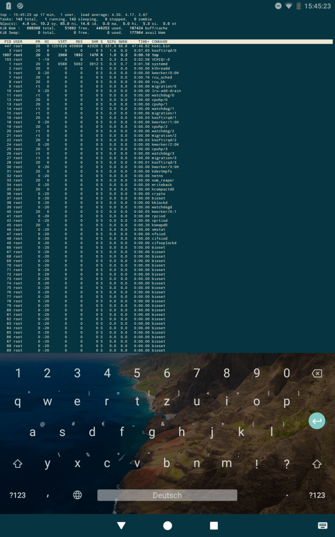

    Most of the time (including Playback) it runs at about 55 to 65°C which is ok. But in irregular time intervals CPU Load goes up and stays that way (when idle mostly), the PI runs at about 85°C (see Screenshot) and shows the overheating Symbol which is when I notice it. Rebooting it fixes that temporarily and Temp drops immediatelly to normal Ranges.
    I can't quite figure out if it's some Addon (which is coincidentally running on both PIs) or the System itself. "Top" doesn't show anything I can see (see another Screenshot). I also have a Log, I turned the Debug Feature on when I saw it overheated again and let it run a few Minutes. If I forgot something please tell me and I try my best to add it.
