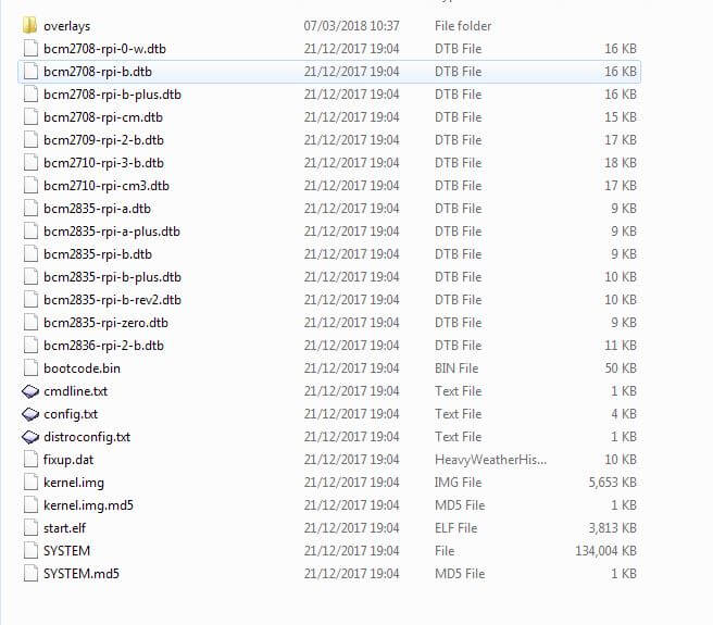

    Edit: I have just created a completely new SD card for LibreElec and the file system looks completely different... The SD card is labelled "LIBREELEC" and I have Kernel and Sytstem files in root.. My other SD cards are labelled "RECOVERY" and the file system looks different.
    One thing I notice on my old card is that some of the folders I mention "OpenElec" which is the OS I used to use before "upgrading" to LibreElec.. So I fear the cards are build completely differently.

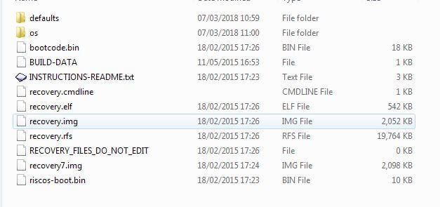

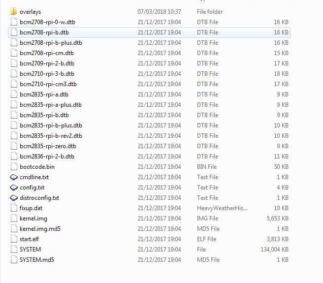

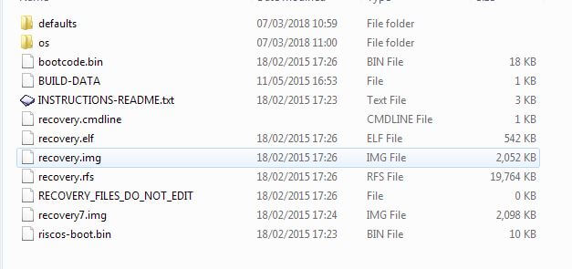

  • So I made a copy of my SD from an Image.. And then copied all of the files in the Windows partition from a clean LibreElec and now it boots without the Rainbow screen.. But I soon get an error stating "Could not mount /dev/mmcblk0p2"
    For what its worth, here are the contents of the 2 Windows partitions, incase anyone has any idea what I could do.
  • It's an old noobs install.
    Ahhha.. Yes.. Thats makes sense as some of the readme files talk about "Noobs"...
    I think its best that i stick with the plan and rebuild it fresh.. As long as I can get everything working again, I will be happy.. I run lights behind my TV using Hyperion and I remember in the OpenElec days that was a nightmare to get working...
