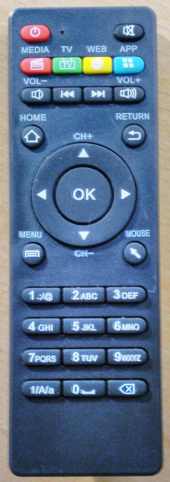

    After 2 reboots the system is working, except for the remote control.
    I have followed the instructions to update the config without success.
    I see some errors in my dmesg but I don't know how fix it.
    [   22.095206@0] remote: Wrong custom code is 0xbb441dcc
    [   22.435852@0] remote: Wrong custom code is 0xbb441dcc
    [   22.891726@0] remote: Wrong custom code is 0xed121dcc
    [   23.183017@0] remote: Wrong custom code is 0xed121dcc
    [   23.441370@0] remote: Wrong custom code is 0xed121dcc
    [   23.732678@0] remote: Wrong custom code is 0xed121dcc
    [   24.353422@0] remote: Wrong custom code is 0xbb441dcc

    Can you try this. Rename this file to remote.conf and place it in /storage/.config and reboot or run remotecfg /storage/.config/remote.conf. your remote factory code seems to be 1dcc and have accordingly attached the file. Best of luck(hope it works, fingers crossed) :)
  • Can you try this. Rename this file to remote.conf and place it in /storage/.config and reboot or run remotecfg /storage/.config/remote.conf. your remote factory code seems to be 1dcc and have accordingly attached the file. Best of luck(hope it works, fingers crossed) :)
    With you file some keys works... but the mapping is wrong.
    For example OK key mute the volume or key "6" is vol+
    What means "your remote factory code seems to be 1dcc"? can I get some information from my current android firmware?
  • With you file some keys works... but the mapping is wrong.
    could you try installing the keymap editor addon and try to remap the keys according to your preference. it is very simple to use. hope this helps. I had similar problem with mini M8S-II and the following post on the wetek forum helped me in creating a custom remote.conf for my box.
    Press any key in your ir control and directly ssh (dmesg -c) in the ssh terminal
    You will get something like this (wrong custom code is 0xXXYYZZZZ)
    If you didn't get this message ,that's mean that your remote control don't support NEC ir protocol try another one
    Write down this code because you will use it later
    now open the remote.conf of ur android firmware
    1- Change the factory code with this 0xZZZZ0001 (ZZZZ is the factory code)
    (ZZZZ is the digits you have got from the ssh above)
    For example if you get in the dmesg
    wrong custom code is 0x14fg76ad
    So your code should be 0x76ad0001
    2- Delete all the lines between Key_begin and key_end
    Don't delete key_begin and key_end lines
    3- now the hard work time
    In this step you have to lead each key in your remote (or you can program only the major function keys) to be understood from wetek
    Wetek cross the commands with dictionary
    Usually each command have a number
    You can find the command number in this file:
    https://github.com/torvalds/linux/bl.../linux/input.h
    For example volume up command number is 115
    Now press the key you want to program it and directly ssh dmesg -c you will find something like this 0xXXYYZZZZ
    Now between key_begin and key_end lines write this
    0xYY 115 ;volumeup
    (The YY is the 5th and 6th digits)
    And only space between 0xYY and the command number
    You should write like the last command line for each key in your ir remote)
    and it should be between Key_begin and key_end lines
    At last save the file (which exist in ./config folder)
    And reboot your wetek and it sould be working
    you can test the file without rebooting with this command
    Edited once, last by TNS (October 10, 2016 at 6:46 PM).
    Ok fixed, thanks for your file that I have used as reference to do a merge.
    remote.conf.txt is the one that I'm using right now and remote.stock.txt the original one from Android firmware.
    The key mapping was inside a custom_begin structure... I have removed also the second custom_begin part.
    Note that I don't know exactly the meaning of that structure but it just works for me.
    Fell free to improve my merge with any comment about the second custom_begin
