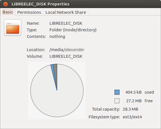

  • Eject the card and plug it back.
    Does not help, no any files shown.
    There is also volume 537 MB, that can't be opened, when try mount it, error message is displayed:
    Unable to access "537 MB Volume"
    Error mounting /dev/mmcblk0p1 at /media/venitek/3463-3434: Command line 'mount -t "vfat" -o "uhelper=udisks2,nodev,nosuid,uid=1000,shortname=mixed,utf8=1,showexec,flush"
    "/dev/mmcblk0p1" "/media/venitek/3463-3434"' exited with non-zero exit status 32: mount: /dev/mmcblk0p1: can't read superblock
