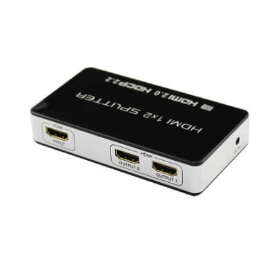

  • I have these hdmi splitter. Even hdr goes through it and of course DTS-HD or TrueHD audio to AVR.
    Specifications
    HDMI version…………………………………………….……………………......................HDMI 2.0, HDCP 2.2
    HDMI resolution …………………...................24/50/60fps/480i/480p/576i/576p/720p/1080i/1080p/2160p
    Supports video color format ....………………...……..….…...................24bit/deep color 30bit, 36bit, 48bit
    Supports audio format……..................DTS-HD/Dolby-trueHD/LPCM7.1/DTS/Dolby-AC3/DSD HD(HBR)
    Max bandwidth……………………………….…….......………............……….………………………….600MHz
    Max baud rate…………………….………………….….…………....................………………………..18.0Gbps
    Input/Output TMDS signal ………….…………………………..…...................…….....0.5~1.5Volts p-p(TTL)
    Input/Output DDC signal …………………………………………….....................……...…….5Volts p-p (TTL)
    Input cable distance..…... ……………………….………………….........≤15m AWG26 HDMI standard cable
    Output cable distance…………………………….………......................≤20m AWG26 HDMI standard cable
    Max working current………………………………..…………...................………………………………..800mA
    Power adapter format Input..…………….............................AC100V-240V (50/60Hz) ; Output: DC 5V/1A
    Operating Temperature range……..………...................…….…….……………………….…… (-15 to +55℃)
    Operating Humidity range………………………….….………...................…5 to 90%RH (No Condensation)
    Dimension (L x W x H)………………………….….………...................…...........................110x60x20(mm)
