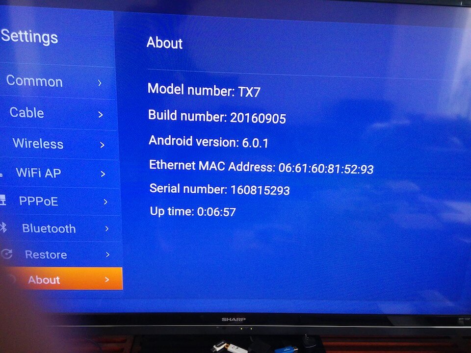

  • I can do a full TWRP backup and share if I find a version that works with Nougat... but I doubt that you could upgrade a 6.0 box to Nougat as Nougat uses different partitions (the same reason why TWRP for Android 6 does not work for 7).
    Edited once, last by kszabo (February 7, 2018 at 6:34 PM).

    I did not find any TWRP that works with Tx7 and Android 7 (tried several versions) so no backup of the firmware till now.
  • same one: i need the dtb from the stock android image to wipe LE and go back to android. please help me guys!
    Were you on Marshmallow ? If "yes" I can give you the device tree.
    If you were on Nougat 7. "Happy Chinese New Year". I can't help you.
  • Were you on Marshmallow ? If "yes" I can give you the device tree.
    thank you for your tempestive answer. to be more accurate, the device is the z11 pro (zenoplige) but inside is litterally the same (or tx3/tx5).
    marshmallow is ok.
