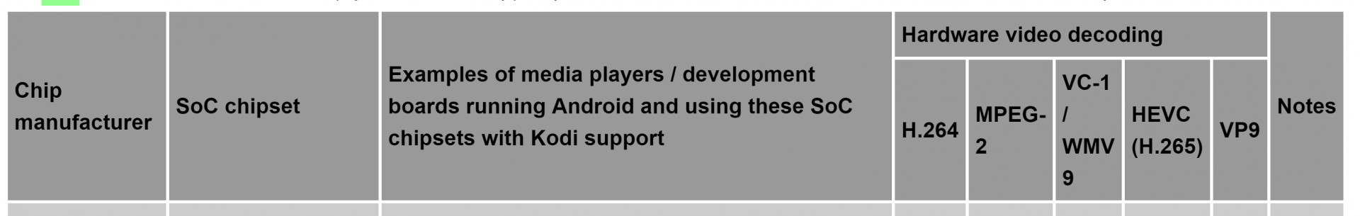

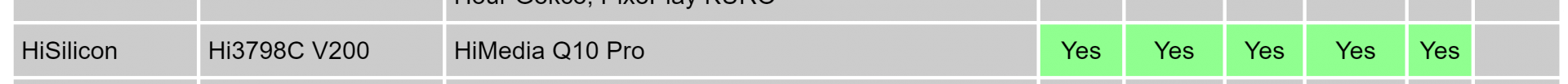

It is funny, when I was buying my Q5 Pro I looked at the official Kodi hardware support page and saw this:
So I thought that Kodi is very well supported on hisilicon chipset. Of course the hw decoding is only one side of the story, although a very important one. It looks very misleading now. Kodi on Q5 Pro is not working well at all. The media center app plays videos a lot better (probably using proprietary interfaces). The chances of LE port are close to 0.
Something tells me my box will end up on ebay soon.
not sure from where you got the informations ^^^ (link?)
support is not equal support ![]()
That the Himedia has some fundamentally problems is sadly nothing new
especially if you consider that they are high priced devices and no china garage manufacture stuff or 20€. If you need those kind of Android Player an Shield is always a better choice also price wise they are very similar.
hmpf that is ofc very suspicious because nobody told you at the page if it works native or due an extremely ugly hack ![]()
kodi works at HiMedia Q10 Pro - but well just with that hack aka "wrapper", so this page is rather misleading at this point
