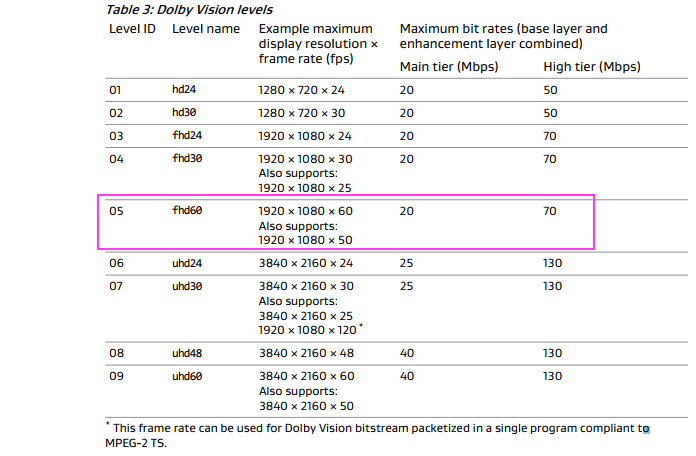

I had a look at this refurbished ATV offer and found the following in the ATV spec:
TV and Video
H.264/HEVC SDR video up to 2160p, 60 fps, Main/Main 10 profile
HEVC Dolby Vision (Profile 5)/HDR10 (Main 10 profile) up to 2160p
I had a quick look at Dolby Vision Profiles and Levels and found the following
It looks like Profile 5 is for 1080p resolutions only.
Looks pretty useless to me.
Hmmm, sounds pretty gloomy...

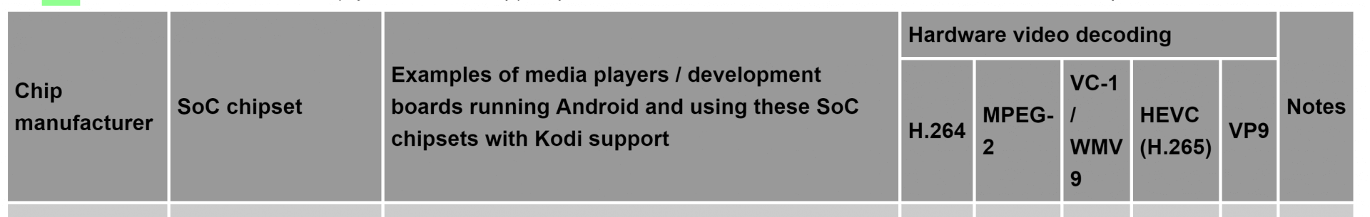

It is funny, when I was buying my Q5 Pro I looked at the official Kodi hardware support page and saw this:
So I thought that Kodi is very well supported on hisilicon chipset. Of course the hw decoding is only one side of the story, although a very important one. It looks very misleading now. Kodi on Q5 Pro is not working well at all. The media center app plays videos a lot better (probably using proprietary interfaces). The chances of LE port are close to 0.
Something tells me my box will end up on ebay soon.
