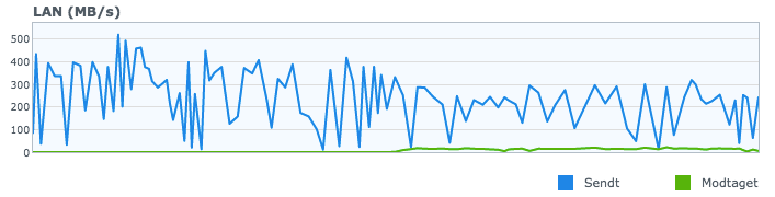

    Because of the trouble i tried to transfer the file from my NAS to the NUC's built in SSD, using filemanager in KODI. When i try that the transfer speed according to the NUC is 9-12 MB/s which again is too slow on a gigabit network. But when i look in the NAS interface it still tells me the transfer speed is way higher than it should be like in the picture.

  • Peaks of 500 MB/s is a bit... enthousiastic in my view. :)
    On paper, gigabit does 1,000 Mb/s, meaning 125 MB/s . In reality counting in the network protocol overhead, a 115-120 MB/s constant throughput would be the absolute maximum. NFS is the one with a leaner overhead, thus should be smoother than SMB. However, your mileage may vary.
    Perhaps you have set a higher MTU size, which might show a different speed graphic, but afaik gigabit cannot be "turbo-boosted" to 500 MB/s.

  • I think the Graph is up to date, it shows almost 100% correct on all other transfers.
    I have done some further testing from another NUC i got.
    Here i got close to 20MB/s, but again that is not much.
    When I download with 20MB/s with my NUC from my Synology shows the stats in the Synology 3-500 MB/s. I then download the same file with my Macbook Air from my nas over Wifi with around 30 MB/S and my Synology shows 30 MB/s.

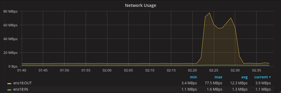

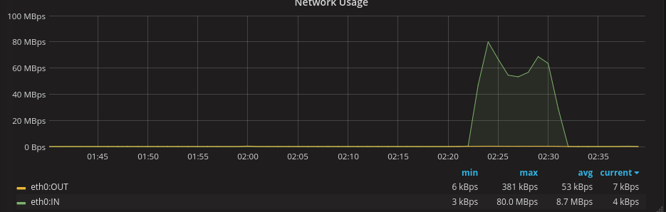

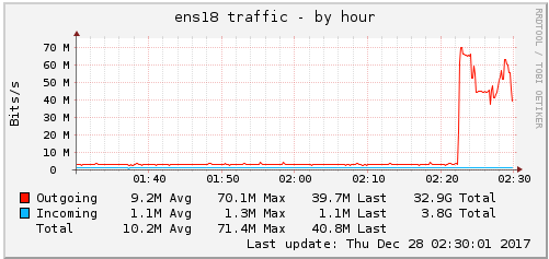

  • These are graphs on three 4k samples playback
    This is the server using rrdgraph
    Same server using grafana/telegraf
    This is kodi network interface graph also grafana/telegraf
    The samples are
    LG_NASA_HDR
    LG_CHESS_HDR and
    Samsung_UHD_Soccer_Barcelona_Atletico_Madrid
    They are around 40-60Mbit/s bitrate files
  • But it is still the graph that is wrong... You have a 1000Mbit/second connection. It is a physical impossibility for you to be getting more than 125Mbytes/second down that cable. As mentioned above, with overheads it will be less than that. Even with some traffic in both directions it will still be less than shown. The graph software seems not to like the way that Kodi fills and maintains the buffers while playing, but it's still a problem with the graphing software, not with Kodi.
