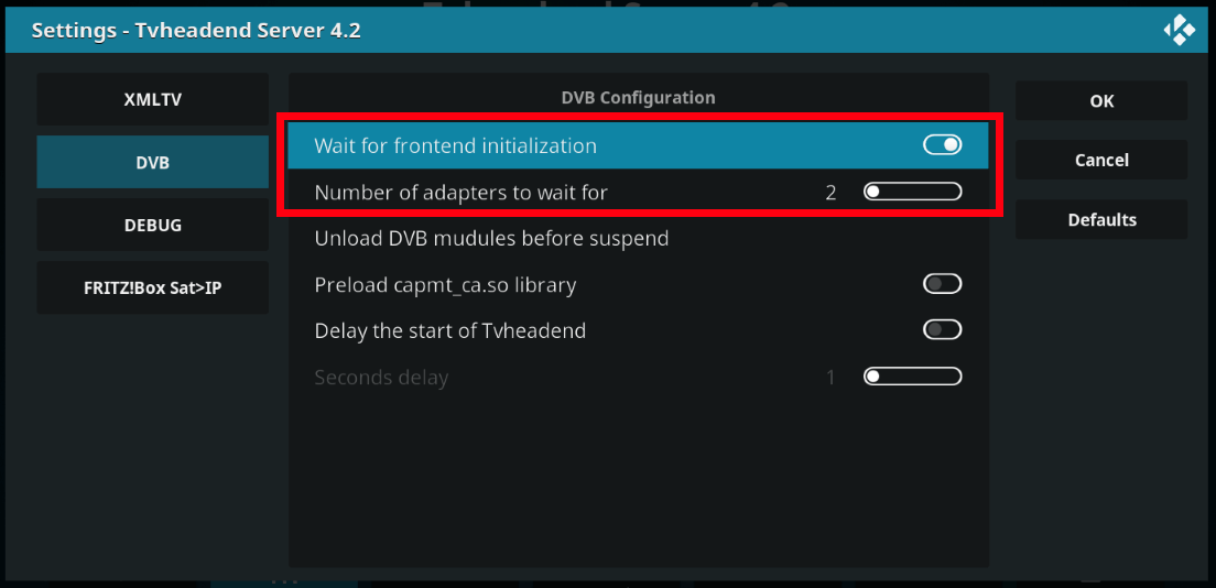

    tvheadend service does not start because it's waiting for the number of configured USB dvb-t receivers.
    Therefore I need to re-init USB from shell. Something comparable to unplug - plug the USB sticks.
    How is that be done with systemd? I've digged in the internet how this can be achieved but I may not have used the right search terms.

  • It's on restart. With the most recent built of LibreELEC 8.2 for Odroid C2 tvheadend server seems to be a bit unstabile. I don't be fully sure if this build is to blame therefore I don't raise a bug report for now.
    That's the reason for nightly reboots.
    I'll try to delay start of tvheadend. What do you suggest? Would 5 Sek. be a good value to start with?
    EDIT: Tried it with 5 sec., but wait a few days (and restarts) until reporting success...
