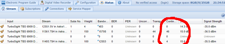

  • OK.. Update...
    I have replaced the Mini USB cord between the PC and the playTV and so far had a stream going for the past few hours which is awesome!
    I am howevergetting a few continuity errors
    Is this normal?
  • "some" errors are no problem, if the count is always increasing (every sec) then something else is problematic (cable, reception, bad tuner ...)
    Hi CvH
    As you can see from my logs they happen anything between 3 and 10 minutes.
    The log above is the local client just playing a channel constantly for a few hours.
