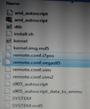

    Sorry, weekend was busy, I downloaded your mod flashed to SD Card, insert into my box nothing happen, TV screen was blank, I tried toothpick same nothing happen, so what other option can you think of.

    Have you replaced dbt.img with one corresponding to your box? In my SD .img is dtb for KI Pro.

  • You have to copy dtb.img from running SD card to new one. In your first picture 3rd file shown as 'dtb'.
