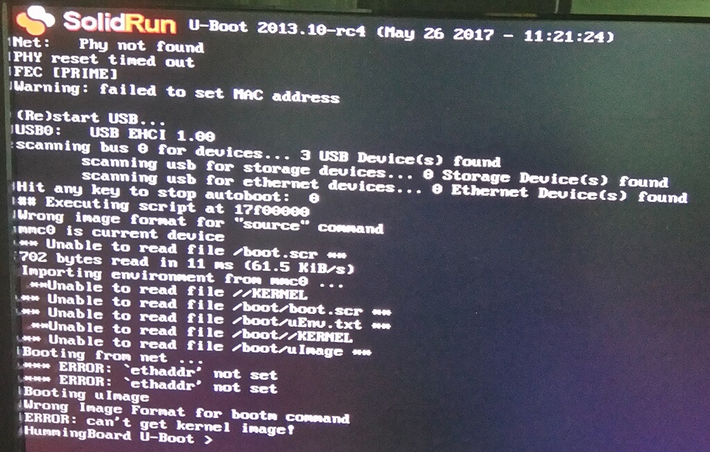

I have a Riotboard (with imx6) and I'd like to install Libreelec on it.
Is it a chance to install Libreelec on EMMC ?
I'm a beginner and I tried with LibreELEC-imx6.arm-7.90.008-matrix-sr-3.14.tar and LibreELEC-imx6.arm-8.0.2-matrix-3.14-sr.tar.
Also I tried with LibreELEC-imx6.arm-8.0.2-4.8-xbian.img.gz and a SD Card.
Every time I get black screen on HDMI and on Terminal.
If I try to write Ubuntu or Android from Element14 all is OK.
Could someone help me with a step by step tutorial or the files which must be written on EMMC ?
