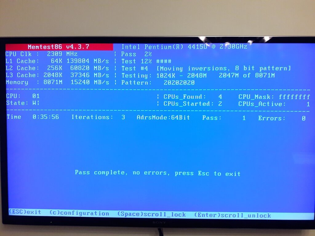

OK - I'm currently testing RAM - I'll get back with answer when it's finished.
Unfortunately, it won't be as easy as bad memory module - error count 0.
I also checked booting with single module - both of them in both memory slots - no change.

Second pass of memtest also 0 errors - i think it's not that issue.
