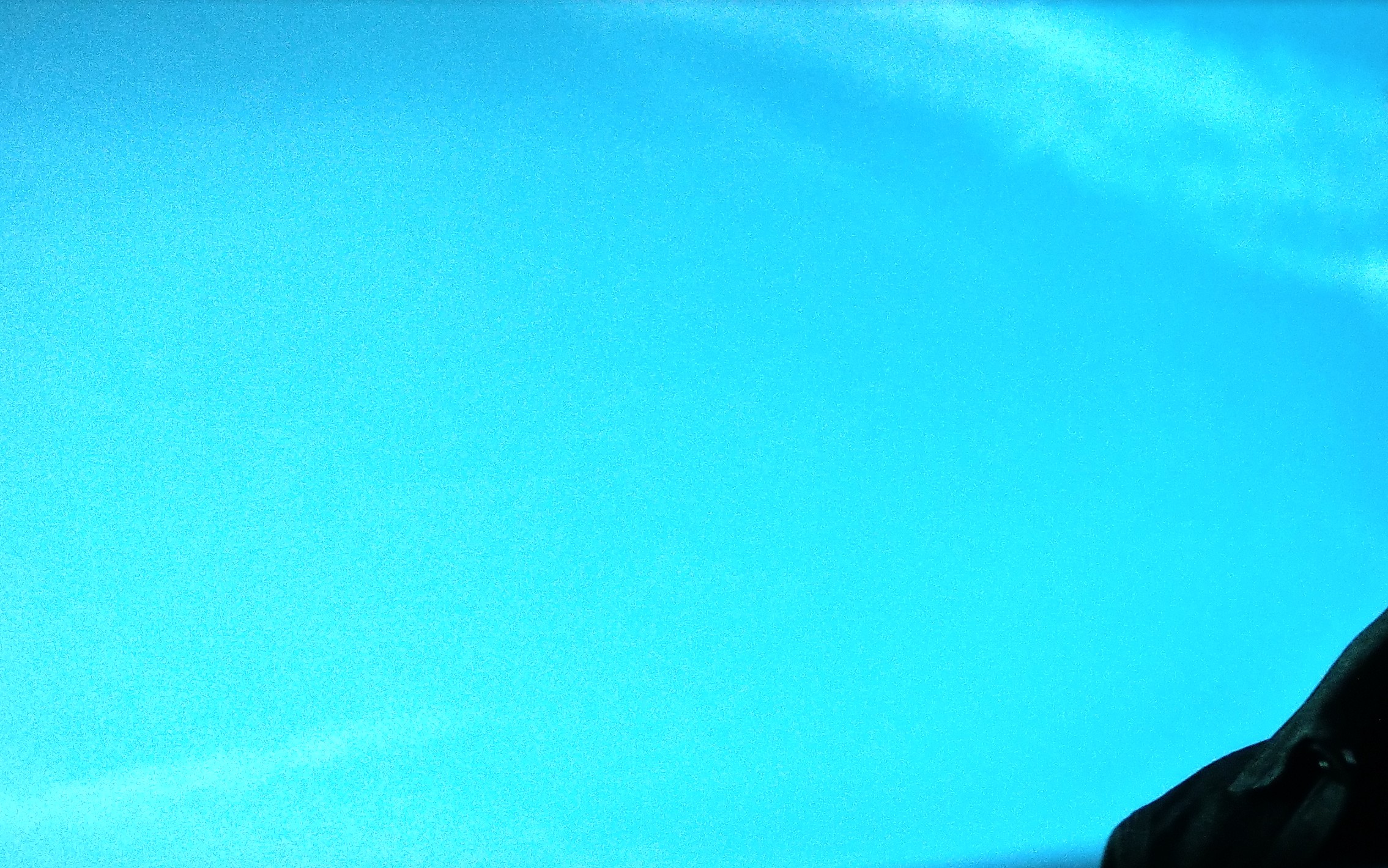

    I took pictures instead:
    Jarvis:
    Krypton:
    (It only shows 4:47 on the Jarvis picture because of Unpause Jumpback, which I set to 4 seconds. It is not installed in Krypton yet.)
