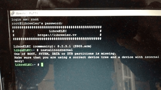

    Unfortunately I have the wrong order held upgrade. I can now no longer upgrade (wrong image). In order to be able to upgrade from build 8.0 I need build the dtb value 8.0. Who can give me the parameters for the 8.0 build?

    Try this.
    My box is the S905 MXQ NEXBOX Pro 4 k '.
    It took me a lot of time to the box flashing it. None of the mentioned possibilities on this forum worked in my case. The following steps brought luck.
    - Copy the image to SD with rufes.exe.
    - Copy the new dtb.img as prescribed. (gxbb_p200_1G_100M_RealtekWiFi.dtb)
    - But then the trick. Zip the ' aml_autoscript ' file from the SD and copy it to the SD card. (Leave the existing aml_autoscript).
    - Use the update app in andoid and update the zip file on the SD card.
    Voila, it works! Then went flashing as expected.
    (It boots first with the NEXBOX logo, the libreelec logo appears briefly after.)
    Tribute to the creator of this product. It works great.
