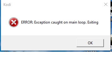

    It is not only S905 problem, i tryed with windows 10 64 bit, and kodi 16.1 with the same result.
    Collect photo information took already 10 minutes, and after seeing 1-2 photos, error.
    Every time, when i go to photo directory, make 10 minute long collecting information, and when i click to one picture, then error.
    With windows explorer, and picture viewer i haver no problems.
