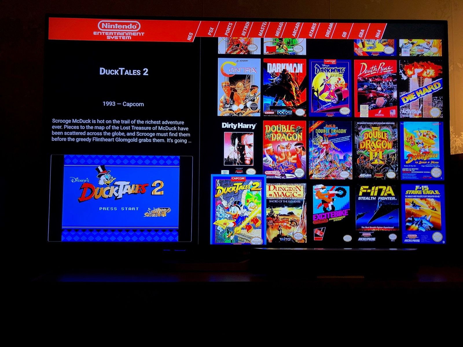

    Included an attachment of how the setup looks when done.

    I really enjoyed escalade's work with RetroELEC but I wanted to have my personal touch on the software, so I just ended up doing an Ubuntu 18.04 minimal install and then installed RetroPie (with Pegasus FE) + Kodi on it (can run Steam too, even in BPM). The upside with doing this is that you'll have access to more drivers and aren't limited to what's included in RetroELEC (or LibreELEC for that matter). You'll also be using Ubuntu which is widely supported and discussed in forums should you run into any issues or want to add something of your own.
    Here's what I did if anyone is interested in trying:
    NOTES:
    Also, make sure to install Pegasus FE from RetroPie Setup under experimental packages if videos aren't playing after scraping them.
    You can copy & save that as a file in your user home dir as "retropie_install.sh" for example and then run the cmd: "chmod +x retropie_install.sh"
    execute with "sudo sh retropie_install.sh" afterwards. After a reboot you should now see the Pegasus frontend, you can scrape games with SkraperUI (run it from a Windows PC and point to your Ubuntu machine's LAN IP / name).
    Good luck with your new project!
