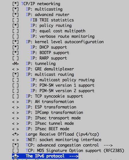

You could enable IP: Foo (IP protocols) over UDP and you will get NET_UDP_TUNNEL too.
I will check again, but in the kernel config I didn't spot that either.
I'm exploring wireguard too while looking into improving crypto speeds, but I can't see in the Amlogic kernel configuration (make menuconfig) the option CONFIG_NET_UDP_TUNNEL which is a requirement (Installation - WireGuard). All the other kernel requirements are satisfied.
