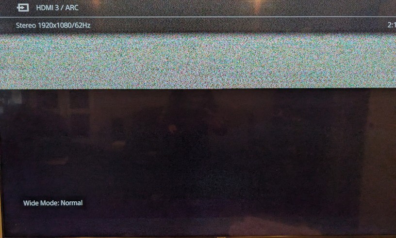

So today I noticed when I have the browser open with the resolution in Flatpak set to 1080P and screen is garbled, moving mouse to top right hand corner to close, kodi was restarting up garbled as well, but if I unplug and re-plug of the HDMI lead gives me the correct image at 1080P60.
kodi.log.old as after boot and display is ok.
kodi.log is after firefox has closed and screen is garbled
When I open the browser if I pull the HDMI and plug back in the display comes right but at 4k resolution.

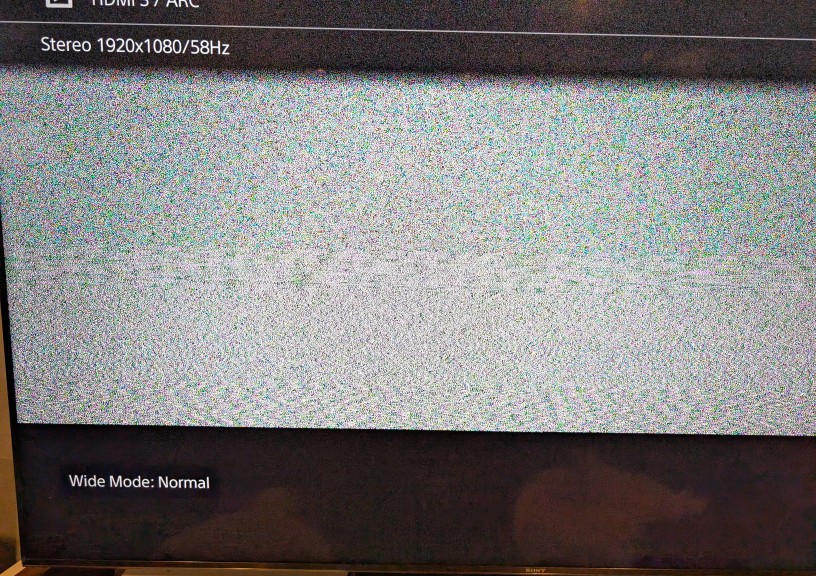

I did some testing, I am using a MeLE Quieter 4C N100, latest BIOS. It does not have an LSPCON chip inside, /sys/class/drm shows HDMI connectors and dmesg doe not list the device.
I have found this issue only happens when plugged into the AVR, directly into the TV it works OK.
One thing that is interesting is the TV is reporting the signal is 1080P@62 htz when the screen image is garbled. I also tried getedid create in case of it being a edid issue but no luck.
I installed version 20260505, I am able to change resolution of Kodi with this version without problems but cannot test a flatpak app as its not available.
I will re-install the newest version again and see what logs I can get
Hi, I love the direction LE is taking and I have been hoping for this for a long time. I am currently running this on an AMD box and so far no issues. I thought I would swap to a small N100 NUC and it mostly works. The N100 seems to have an issue changing resolution. Its connected to an AVR -> TV and after install it boots into 4K resolution. I can play all my media no issue. I also love being able to use a web browser (firefox) for netflix and prime content. This works fine to.
This is until I try and drop Kodi resolution to 1080P then the screen turns to static, I leave it to auto return to 4k and the picture returns. Also I dont really want the web browser in 4k either so dropping that to 1080P has the same result, screen is static. I just use the mouse to top right and corner and click which hopefully shuts the browser down and if I get it right Kodi will once again reappear in 4k.
Is this a me only issue?

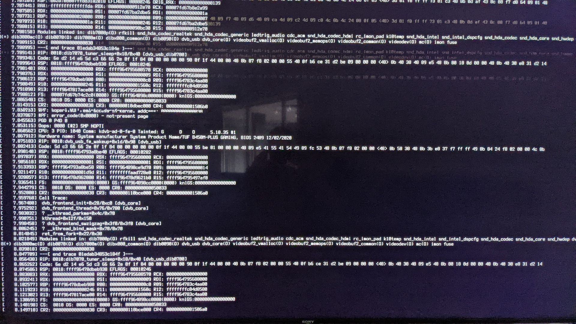

Hi,
Just installed 9.95.4 x86_64 on my AMD system.
After the first boot and start-up sequence I installed the following addons :-
TVHeadend 4.2
LCDProc
XBMC LCDProc
Chrome
TVHeadend PVR Client
DVB-T Hardware is the old sony PlayTV usb
Everything works perfectly the first boot. I can setup TVHeadend, tune the channels and watch TV until either a reboot or power cycle, then I get kernel errors and the DVB tuners are gone and unable to get them back and end up reverting to 9.2.6. I had this same behavior with 9.95.3 as well.
from Journctl :-
Jun 01 11:55:33 LibreELEC kernel: RIP: 0010:dib7070_tuner_sleep+0x18/0x40 [dvb_usb_dib0700]
Jun 01 11:55:33 LibreELEC kernel: Code: 6e d2 14 e6 5d c3 66 66 2e 0f 1f 84 00 00 00 00 00 90 0f 1f 44 00 00 48 8b 87 f8 02 00 00 55 40 0f b6 ce 31 d2 be 09 00 00 00 <48> 8b 40 38 48 89 e5 48 8b 80 18 0d 00 00 48 8b 4
Jun 01 11:55:33 LibreELEC kernel: RSP: 0018:ffff96478dbeb938 EFLAGS: 00010246
Jun 01 11:55:33 LibreELEC kernel: RAX: 0000000000000000 RBX: ffff964795688570 RCX: 0000000000000000
Jun 01 11:55:33 LibreELEC kernel: RDX: 0000000000000000 RSI: 0000000000000009 RDI: ffff964795688000
Jun 01 11:55:33 LibreELEC kernel: RBP: ffff96478dbeb980 R08: 00000000000000c0 R09: ffff964783c4aa80
Jun 01 11:55:33 LibreELEC kernel: R10: 0000000000000246 R11: 000000000001560c R12: ffffffffc04d8580
Jun 01 11:55:33 LibreELEC kernel: R13: ffff9647817ace00 R14: ffff964795688000 R15: ffff964783c4aa80
Jun 01 11:55:33 LibreELEC kernel: FS: 00007fd67b74c2c0(0000) GS:ffff964898c00000(0000) knlGS:0000000000000000
Jun 01 11:55:33 LibreELEC kernel: CS: 0010 DS: 0000 ES: 0000 CR0: 0000000080050033
Jun 01 11:55:33 LibreELEC kernel: CR2: 0000000000000038 CR3: 000000010dbec000 CR4: 00000000001506b0
Jun 01 11:55:33 LibreELEC kernel: Call Trace:
Jun 01 11:55:33 LibreELEC kernel: ? dib0070_attach+0x81/0x380 [dib0070]
Jun 01 11:55:33 LibreELEC kernel: dib7070p_tuner_attach+0x66/0x130 [dvb_usb_dib0700]
Jun 01 11:55:33 LibreELEC kernel: dvb_usb_adapter_frontend_init+0xab/0x140 [dvb_usb]
Jun 01 11:55:33 LibreELEC kernel: dvb_usb_device_init.cold+0x3bd/0x50a [dvb_usb]
Jun 01 11:55:33 LibreELEC kernel: dib0700_probe+0x6f/0x120 [dvb_usb_dib0700]
Jun 01 11:55:33 LibreELEC kernel: usb_probe_interface+0xf1/0x2b0
Jun 01 11:55:33 LibreELEC kernel: really_probe+0xff/0x460
Jun 01 11:55:33 LibreELEC kernel: driver_probe_device+0xe9/0x160
Jun 01 11:55:33 LibreELEC kernel: device_driver_attach+0xab/0xb0
Jun 01 11:55:33 LibreELEC kernel: __driver_attach+0x8f/0x150
Jun 01 11:55:33 LibreELEC kernel: ? device_driver_attach+0xb0/0xb0
Jun 01 11:55:33 LibreELEC kernel: bus_for_each_dev+0x7e/0xc0
Jun 01 11:55:33 LibreELEC kernel: driver_attach+0x1e/0x20
Jun 01 11:55:33 LibreELEC kernel: bus_add_driver+0x135/0x1f0
Jun 01 11:55:33 LibreELEC kernel: driver_register+0x91/0xf0
Jun 01 11:55:33 LibreELEC kernel: usb_register_driver+0x89/0x130
Jun 01 11:55:33 LibreELEC kernel: ? 0xffffffffc04dc000
Jun 01 11:55:33 LibreELEC kernel: dib0700_driver_init+0x23/0x1000 [dvb_usb_dib0700]
Jun 01 11:55:33 LibreELEC kernel: do_one_initcall+0x48/0x1d0
Jun 01 11:55:33 LibreELEC kernel: ? kmem_cache_alloc_trace+0xe3/0x230
Jun 01 11:55:33 LibreELEC kernel: ? do_init_module+0x28/0x280
Jun 01 11:55:33 LibreELEC kernel: do_init_module+0x62/0x280
Jun 01 11:55:33 LibreELEC kernel: load_module+0x27bc/0x2b10
Jun 01 11:55:33 LibreELEC kernel: __do_sys_finit_module+0xc2/0x120
Jun 01 11:55:33 LibreELEC kernel: __x64_sys_finit_module+0x1a/0x20
Jun 01 11:55:33 LibreELEC kernel: do_syscall_64+0x38/0x50
Jun 01 11:55:33 LibreELEC kernel: entry_SYSCALL_64_after_hwframe+0x44/0xa9
Jun 01 11:55:33 LibreELEC kernel: RIP: 0033:0x7fd67b8e2a99
Jun 01 11:55:33 LibreELEC kernel: Code: 00 c3 66 2e 0f 1f 84 00 00 00 00 00 0f 1f 44 00 00 48 89 f8 48 89 f7 48 89 d6 48 89 ca 4d 89 c2 4d 89 c8 4c 8b 4c 24 08 0f 05 <48> 3d 01 f0 ff ff 73 01 c3 48 8b 0d af 43 0c 00 f
Jun 01 11:55:33 LibreELEC kernel: RSP: 002b:00007ffdd31a2e18 EFLAGS: 00000246 ORIG_RAX: 0000000000000139
Jun 01 11:55:33 LibreELEC kernel: RAX: ffffffffffffffda RBX: 0000000000912e70 RCX: 00007fd67b8e2a99
Jun 01 11:55:33 LibreELEC kernel: RDX: 0000000000000000 RSI: 00007fd67ba2dbe5 RDI: 000000000000001a
Jun 01 11:55:33 LibreELEC kernel: RBP: 0000000000020000 R08: 0000000000000000 R09: 0000000000000007
Jun 01 11:55:33 LibreELEC kernel: R10: 000000000000001a R11: 0000000000000246 R12: 00007fd67ba2dbe5
Jun 01 11:55:33 LibreELEC kernel: R13: 0000000000000000 R14: 000000000090bc30 R15: 0000000000912e70
Jun 01 11:55:33 LibreELEC kernel: Modules linked in: dib7000p(O) rfkill snd_hda_codec_realtek snd_hda_codec_generic ledtrig_audio cdc_acm snd_hda_codec_hdmi rc_imon_pad k10temp snd_hda_intel snd_intel_dspcfg snd_hda_c
Jun 01 11:55:33 LibreELEC kernel: ---[ end trace 01edab34853c184e ]---
Jun 01 11:55:33 LibreELEC kernel: BUG: kernel NULL pointer dereference, address: 0000000000000038
Jun 01 11:55:33 LibreELEC systemd-udevd[395]: Worker [430] terminated by signal 9 (KILL)
Jun 01 11:55:33 LibreELEC systemd-udevd[395]: 1-6:1.0: Worker [430] failed
Jun 01 11:55:34 LibreELEC kernel: #PF: supervisor read access in kernel mode
Jun 01 11:55:34 LibreELEC kernel: #PF: error_code(0x0000) - not-present page
Jun 01 11:55:34 LibreELEC kernel: PGD 0 P4D 0
Jun 01 11:55:34 LibreELEC kernel: Oops: 0000 [#2] SMP NOPTI
Jun 01 11:55:34 LibreELEC kernel: CPU: 3 PID: 1040 Comm: kdvb-ad-0-fe-0 Tainted: G D O 5.10.35 #1
Jun 01 11:55:34 LibreELEC kernel: Hardware name: System manufacturer System Product Name/TUF B450M-PLUS GAMING, BIOS 2409 12/02/2020
Jun 01 11:55:34 LibreELEC kernel: RIP: 0010:dvb_usb_fe_wakeup+0x1d/0x90 [dvb_usb]
Jun 01 11:55:34 LibreELEC kernel: Code: 5d c3 66 66 2e 0f 1f 84 00 00 00 00 00 0f 1f 44 00 00 55 be 01 00 00 00 48 89 e5 41 55 41 54 49 89 fc 53 48 8b 87 f8 02 00 00 <48> 8b 58 38 48 8b 3b e8 37 f7 ff ff 49 8b 84 24 f
Jun 01 11:55:34 LibreELEC kernel: RSP: 0018:ffff964793a8be40 EFLAGS: 00010282
Jun 01 11:55:34 LibreELEC kernel: RAX: 0000000000000000 RBX: ffff964795688000 RCX: 0000000000000000
Jun 01 11:55:34 LibreELEC kernel: RDX: 0000000000000001 RSI: 0000000000000001 RDI: ffff964795688000
Jun 01 11:55:34 LibreELEC kernel: RBP: ffff964793a8be58 R08: ffff964898ce9d70 R09: 0000000000000014
Jun 01 11:55:34 LibreELEC kernel: R10: 0000000000001d9d R11: ffffffffaad728e0 R12: ffff964795688000
Jun 01 11:55:34 LibreELEC kernel: R13: ffff96478d962000 R14: ffff96478d9621b8 R15: ffff964795497af0
Jun 01 11:55:34 LibreELEC kernel: FS: 0000000000000000(0000) GS:ffff964898cc0000(0000) knlGS:0000000000000000
Jun 01 11:55:34 LibreELEC kernel: CS: 0010 DS: 0000 ES: 0000 CR0: 0000000080050033
Jun 01 11:55:34 LibreELEC kernel: CR2: 0000000000000038 CR3: 0000000110bce000 CR4: 00000000001506a0
Jun 01 11:55:34 LibreELEC kernel: Call Trace:
Jun 01 11:55:34 LibreELEC kernel: dvb_frontend_init+0x28/0xc0 [dvb_core]
Jun 01 11:55:34 LibreELEC kernel: dvb_frontend_thread+0x76/0x780 [dvb_core]
Jun 01 11:55:34 LibreELEC kernel: ? __kthread_parkme+0x4c/0x70
Jun 01 11:55:34 LibreELEC kernel: kthread+0x12f/0x150
Jun 01 11:55:34 LibreELEC kernel: ? dvb_frontend_swzigzag+0x3f0/0x3f0 [dvb_core]
Jun 01 11:55:34 LibreELEC kernel: ? __kthread_bind_mask+0x70/0x70
Jun 01 11:55:34 LibreELEC kernel: ret_from_fork+0x22/0x30
Jun 01 11:55:34 LibreELEC kernel: Modules linked in: dib7000p(O) rfkill snd_hda_codec_realtek snd_hda_codec_generic ledtrig_audio cdc_acm snd_hda_codec_hdmi rc_imon_pad k10temp snd_hda_intel snd_intel_dspcfg snd_hda_c
Jun 01 11:55:34 LibreELEC kernel: ---[ end trace 01edab34853c184f ]---
Jun 01 11:55:34 LibreELEC kernel: RIP: 0010:dib7070_tuner_sleep+0x18/0x40 [dvb_usb_dib0700]
Jun 01 11:55:34 LibreELEC kernel: Code: 6e d2 14 e6 5d c3 66 66 2e 0f 1f 84 00 00 00 00 00 90 0f 1f 44 00 00 48 8b 87 f8 02 00 00 55 40 0f b6 ce 31 d2 be 09 00 00 00 <48> 8b 40 38 48 89 e5 48 8b 80 18 0d 00 00 48 8b 4
Jun 01 11:55:34 LibreELEC kernel: RSP: 0018:ffff96478dbeb938 EFLAGS: 00010246
Jun 01 11:55:34 LibreELEC kernel: RAX: 0000000000000000 RBX: ffff964795688570 RCX: 0000000000000000
Jun 01 11:55:34 LibreELEC kernel: RDX: 0000000000000000 RSI: 0000000000000009 RDI: ffff964795688000
Jun 01 11:55:34 LibreELEC kernel: RBP: ffff96478dbeb980 R08: 00000000000000c0 R09: ffff964783c4aa80
Jun 01 11:55:34 LibreELEC kernel: R10: 0000000000000246 R11: 000000000001560c R12: ffffffffc04d8580
Jun 01 11:55:34 LibreELEC kernel: R13: ffff9647817ace00 R14: ffff964795688000 R15: ffff964783c4aa80

dmesg
[ 7.113209] dvb-usb: found a 'Sony PlayTV' in warm state.
[ 7.113298] dvb-usb: will pass the complete MPEG2 transport stream to the software demuxer.
[ 7.118939] dvbdev: DVB: registering new adapter (Sony PlayTV)
[ 7.118943] usb 1-6: media controller created
[ 7.119113] dvbdev: dvb_create_media_entity: media entity 'dvb-demux' registered.
[ 7.781362] usb 1-6: DVB: registering adapter 0 frontend 0 (DiBcom 7000PC)...
[ 7.781374] dvbdev: dvb_create_media_entity: media entity 'DiBcom 7000PC' registered.
[ 7.781520] BUG: kernel NULL pointer dereference, address: 0000000000000038
[ 7.781705] #PF: supervisor read access in kernel mode
[ 7.781853] #PF: error_code(0x0000) - not-present page
[ 7.782008] PGD 10dbaa067 P4D 10dbaa067 PUD 10dbab067 PMD 0
[ 7.782185] Oops: 0000 [#1] SMP NOPTI
[ 7.782268] CPU: 0 PID: 430 Comm: systemd-udevd Tainted: G O 5.10.35 #1
[ 7.782427] Hardware name: System manufacturer System Product Name/TUF B450M-PLUS GAMING, BIOS 2409 12/02/2020
[ 7.782635] RIP: 0010:dib7070_tuner_sleep+0x18/0x40 [dvb_usb_dib0700]
[ 7.782765] Code: 6e d2 14 e6 5d c3 66 66 2e 0f 1f 84 00 00 00 00 00 90 0f 1f 44 00 00 48 8b 87 f8 02 00 00 55 40 0f b6 ce 31 d2 be 09 00 00 00 <48> 8b 40 38 48 89 e5 48 8b 80 18 0d 00 00 48 8b 40 30 e8 31 d2 14
[ 7.783142] RSP: 0018:ffff96478dbeb938 EFLAGS: 00010246
[ 7.783247] RAX: 0000000000000000 RBX: ffff964795688570 RCX: 0000000000000000
[ 7.783389] RDX: 0000000000000000 RSI: 0000000000000009 RDI: ffff964795688000
[ 7.783531] RBP: ffff96478dbeb980 R08: 00000000000000c0 R09: ffff964783c4aa80
[ 7.783674] R10: 0000000000000246 R11: 000000000001560c R12: ffffffffc04d8580
[ 7.783816] R13: ffff9647817ace00 R14: ffff964795688000 R15: ffff964783c4aa80
[ 7.783959] FS: 00007fd67b74c2c0(0000) GS:ffff964898c00000(0000) knlGS:0000000000000000
[ 7.784121] CS: 0010 DS: 0000 ES: 0000 CR0: 0000000080050033
[ 7.784235] CR2: 0000000000000038 CR3: 000000010dbec000 CR4: 00000000001506b0
[ 7.784390] Call Trace:
[ 7.784444] ? dib0070_attach+0x81/0x380 [dib0070]
[ 7.784544] dib7070p_tuner_attach+0x66/0x130 [dvb_usb_dib0700]
[ 7.784665] dvb_usb_adapter_frontend_init+0xab/0x140 [dvb_usb]
[ 7.784785] dvb_usb_device_init.cold+0x3bd/0x50a [dvb_usb]
[ 7.784901] dib0700_probe+0x6f/0x120 [dvb_usb_dib0700]
[ 7.785009] usb_probe_interface+0xf1/0x2b0
[ 7.785095] really_probe+0xff/0x460
[ 7.785168] driver_probe_device+0xe9/0x160
[ 7.785252] device_driver_attach+0xab/0xb0
[ 7.785337] __driver_attach+0x8f/0x150
[ 7.785414] ? device_driver_attach+0xb0/0xb0
[ 7.785502] bus_for_each_dev+0x7e/0xc0
[ 7.785579] driver_attach+0x1e/0x20
[ 7.785652] bus_add_driver+0x135/0x1f0
[ 7.785729] driver_register+0x91/0xf0
[ 7.785805] usb_register_driver+0x89/0x130
[ 7.785889] ? 0xffffffffc04dc000
[ 7.785959] dib0700_driver_init+0x23/0x1000 [dvb_usb_dib0700]
[ 7.786078] do_one_initcall+0x48/0x1d0
[ 7.786157] ? kmem_cache_alloc_trace+0xe3/0x230
[ 7.786252] ? do_init_module+0x28/0x280
[ 7.786332] do_init_module+0x62/0x280
[ 7.786407] load_module+0x27bc/0x2b10
[ 7.786485] __do_sys_finit_module+0xc2/0x120
[ 7.786574] __x64_sys_finit_module+0x1a/0x20
[ 7.786664] do_syscall_64+0x38/0x50
[ 7.786738] entry_SYSCALL_64_after_hwframe+0x44/0xa9
[ 7.786839] RIP: 0033:0x7fd67b8e2a99
[ 7.786912] Code: 00 c3 66 2e 0f 1f 84 00 00 00 00 00 0f 1f 44 00 00 48 89 f8 48 89 f7 48 89 d6 48 89 ca 4d 89 c2 4d 89 c8 4c 8b 4c 24 08 0f 05 <48> 3d 01 f0 ff ff 73 01 c3 48 8b 0d af 43 0c 00 f7 d8 64 89 01 48
[ 7.787289] RSP: 002b:00007ffdd31a2e18 EFLAGS: 00000246 ORIG_RAX: 0000000000000139
[ 7.787441] RAX: ffffffffffffffda RBX: 0000000000912e70 RCX: 00007fd67b8e2a99
[ 7.787585] RDX: 0000000000000000 RSI: 00007fd67ba2dbe5 RDI: 000000000000001a
[ 7.787731] RBP: 0000000000020000 R08: 0000000000000000 R09: 0000000000000007
[ 7.787873] R10: 000000000000001a R11: 0000000000000246 R12: 00007fd67ba2dbe5
[ 7.788015] R13: 0000000000000000 R14: 000000000090bc30 R15: 0000000000912e70
[ 7.788158] Modules linked in: dib7000p(O) rfkill snd_hda_codec_realtek snd_hda_codec_generic ledtrig_audio cdc_acm snd_hda_codec_hdmi rc_imon_pad k10temp snd_hda_intel snd_intel_dspcfg snd_hda_codec snd_hda_core s
nd_hwdep dvb_usb_dib0700(+) dib3000mc(O) dib0070(O) dib7000m(O) dibx000_common(O) dib0090(O) dvb_usb dvb_core(O) videobuf2_vmalloc(O) videobuf2_memops(O) videobuf2_common(O) videodev(O) mc(O) imon fuse
[ 7.788915] CR2: 0000000000000038
[ 7.788995] ---[ end trace 01edab34853c184e ]---
[ 7.789141] RIP: 0010:dib7070_tuner_sleep+0x18/0x40 [dvb_usb_dib0700]
[ 7.789346] Code: 6e d2 14 e6 5d c3 66 66 2e 0f 1f 84 00 00 00 00 00 90 0f 1f 44 00 00 48 8b 87 f8 02 00 00 55 40 0f b6 ce 31 d2 be 09 00 00 00 <48> 8b 40 38 48 89 e5 48 8b 80 18 0d 00 00 48 8b 40 30 e8 31 d2 14
[ 7.789964] RSP: 0018:ffff96478dbeb938 EFLAGS: 00010246
[ 7.790140] RAX: 0000000000000000 RBX: ffff964795688570 RCX: 0000000000000000
[ 7.790376] RDX: 0000000000000000 RSI: 0000000000000009 RDI: ffff964795688000
[ 7.790612] RBP: ffff96478dbeb980 R08: 00000000000000c0 R09: ffff964783c4aa80
[ 7.790849] R10: 0000000000000246 R11: 000000000001560c R12: ffffffffc04d8580
[ 7.791090] R13: ffff9647817ace00 R14: ffff964795688000 R15: ffff964783c4aa80
[ 7.798812] FS: 00007fd67b74c2c0(0000) GS:ffff964898c00000(0000) knlGS:0000000000000000
[ 7.806548] CS: 0010 DS: 0000 ES: 0000 CR0: 0000000080050033
[ 7.814315] CR2: 0000000000000038 CR3: 000000010dbec000 CR4: 00000000001506b0
[ 7.819817] BUG: kernel NULL pointer dereference, address: 0000000000000038
[ 7.830133] #PF: supervisor read access in kernel mode
[ 7.837867] #PF: error_code(0x0000) - not-present page
[ 7.845563] PGD 0 P4D 0
[ 7.853115] Oops: 0000 [#2] SMP NOPTI
[ 7.860562] CPU: 3 PID: 1040 Comm: kdvb-ad-0-fe-0 Tainted: G D O 5.10.35 #1
[ 7.867912] Hardware name: System manufacturer System Product Name/TUF B450M-PLUS GAMING, BIOS 2409 12/02/2020
[ 7.875183] RIP: 0010:dvb_usb_fe_wakeup+0x1d/0x90 [dvb_usb]
[ 7.882413] Code: 5d c3 66 66 2e 0f 1f 84 00 00 00 00 00 0f 1f 44 00 00 55 be 01 00 00 00 48 89 e5 41 55 41 54 49 89 fc 53 48 8b 87 f8 02 00 00 <48> 8b 58 38 48 8b 3b e8 37 f7 ff ff 49 8b 84 24 f8 02 00 00 4c 8b
[ 7.890140] RSP: 0018:ffff964793a8be40 EFLAGS: 00010282
[ 7.897837] RAX: 0000000000000000 RBX: ffff964795688000 RCX: 0000000000000000
[ 7.905618] RDX: 0000000000000001 RSI: 0000000000000001 RDI: ffff964795688000
[ 7.913393] RBP: ffff964793a8be58 R08: ffff964898ce9d70 R09: 0000000000000014
[ 7.921147] R10: 0000000000001d9d R11: ffffffffaad728e0 R12: ffff964795688000
[ 7.928857] R13: ffff96478d962000 R14: ffff96478d9621b8 R15: ffff964795497af0
[ 7.936541] FS: 0000000000000000(0000) GS:ffff964898cc0000(0000) knlGS:0000000000000000
[ 7.944279] CS: 0010 DS: 0000 ES: 0000 CR0: 0000000080050033
[ 7.952000] CR2: 0000000000000038 CR3: 0000000110bce000 CR4: 00000000001506a0
[ 7.959768] Call Trace:
[ 7.967480] dvb_frontend_init+0x28/0xc0 [dvb_core]
[ 7.975292] dvb_frontend_thread+0x76/0x780 [dvb_core]
[ 7.983032] ? __kthread_parkme+0x4c/0x70
[ 7.990751] kthread+0x12f/0x150
[ 7.998458] ? dvb_frontend_swzigzag+0x3f0/0x3f0 [dvb_core]
[ 8.006245] ? __kthread_bind_mask+0x70/0x70
[ 8.014045] ret_from_fork+0x22/0x30
[ 8.021849] Modules linked in: dib7000p(O) rfkill snd_hda_codec_realtek snd_hda_codec_generic ledtrig_audio cdc_acm snd_hda_codec_hdmi rc_imon_pad k10temp snd_hda_intel snd_intel_dspcfg snd_hda_codec snd_hda_core s
[ 8.039018] CR2: 0000000000000038
[ 8.047709] ---[ end trace 01edab34853c184f ]---
[ 8.056438] RIP: 0010:dib7070_tuner_sleep+0x18/0x40 [dvb_usb_dib0700]
[ 8.065262] Code: 6e d2 14 e6 5d c3 66 66 2e 0f 1f 84 00 00 00 00 00 90 0f 1f 44 00 00 48 8b 87 f8 02 00 00 55 40 0f b6 ce 31 d2 be 09 00 00 00 <48> 8b 40 38 48 89 e5 48 8b 80 18 0d 00 00 48 8b 40 30 e8 31 d2 14
[ 8.074586] RSP: 0018:ffff96478dbeb938 EFLAGS: 00010246
[ 8.083883] RAX: 0000000000000000 RBX: ffff964795688570 RCX: 0000000000000000
[ 8.093241] RDX: 0000000000000000 RSI: 0000000000000009 RDI: ffff964795688000
[ 8.102577] RBP: ffff96478dbeb980 R08: 00000000000000c0 R09: ffff964783c4aa80
[ 8.111923] R10: 0000000000000246 R11: 000000000001560c R12: ffffffffc04d8580
[ 8.121302] R13: ffff9647817ace00 R14: ffff964795688000 R15: ffff964783c4aa80
[ 8.130695] FS: 0000000000000000(0000) GS:ffff964898cc0000(0000) knlGS:0000000000000000
[ 8.140198] CS: 0010 DS: 0000 ES: 0000 CR0: 0000000080050033
[ 8.149718] CR2: 0000000000000038 CR3: 0000000110bce000 CR4: 00000000001506a0
