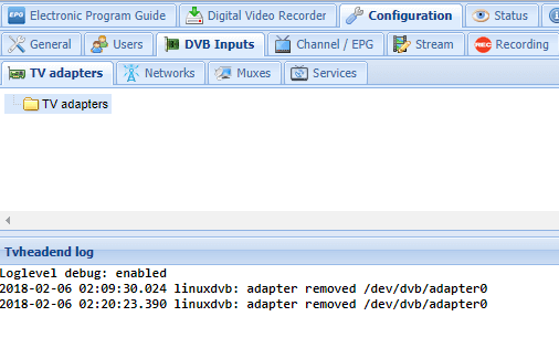

    This is very strange, if I enable debug loglevel in tvheadend gui, it actually acknowledges when I disconnect the adapter, but there's no feedback when I connect it again:

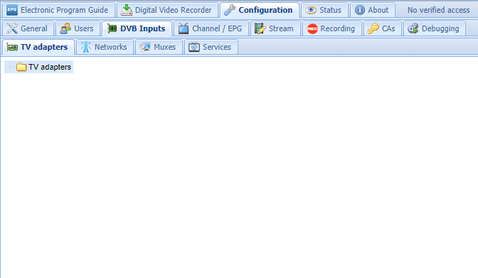

    What's strange is that the device, despite being detected, is not listed in the TV Adapters list:
    Could this be driver related?

    Now the service starts on boot, and web gui is available as soon as libreelec loads, but now, my TV adapter is no longer listed on Configuration->DVB Inputs, so I can't setup the channels.
