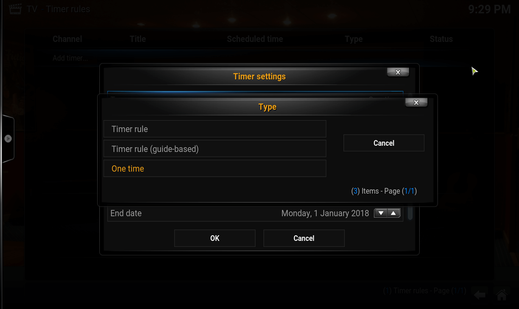

    After a lot of editing and testing, i figured it.
    The problem occurs if the strings in the "TV - Timer rule" list pictured above are translated to Greek.
    The guilty strings are #820 - #823 in the "strings.po" file, inside "resource.language.el_gr" addon.
    After i found and corrected them, Kodi with tvheadend and pvr.hts work fine in Greek.
    I attach a corrected "resource.language.el_gr" addon for everyone with this problem (Kodi - addons - install addon from zip file), as it seems to occur in all platforms. It's a dirty patch but it's all i could do. I think the code in Kodi needs corrections.
    resource.language.el_gr-OK.zip
    If possible, you guys could report this up the chain to Kodi team.
