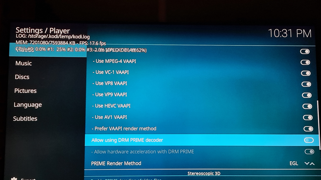

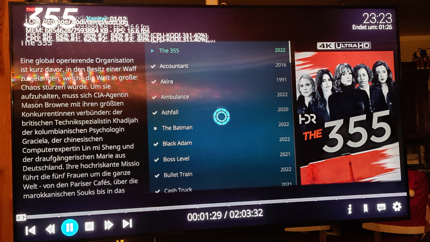

Hi chewitt
The problem with the 4K movies was caused by a setting in Kodi Player.
I had enabled the Setting / Player / Videos / Allow using DRM Prime decoder.
Deactivated this setting again and voilà - also the 4K movies are displayed.

Unfortunately, no 4k movie is displayed. The player just shows a rotating circle and the HD audio plays correctly.

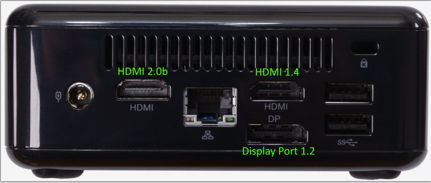

Thanks for the quick reply.
The HDMI connection sequence is: Beebox-AVR-eARC-TV and also tested Beebox-TV-eARC-AVR.
I had the Beebox connected to the TV (Samsung) and then to the AVR, on HDMI port 2.0.
I have three drivers to choose from: 1st DP port DEV=0; 2nd HDMI DEV=1; 3rd HDMI DEV=2.
The drivers 2nd HDMI DEV=1 and 3rd HDMI DEV=2. have no audio.
Although I have connected the AVR to HDMI port 2.0b I should select 1st DP port DEV=0, really?
