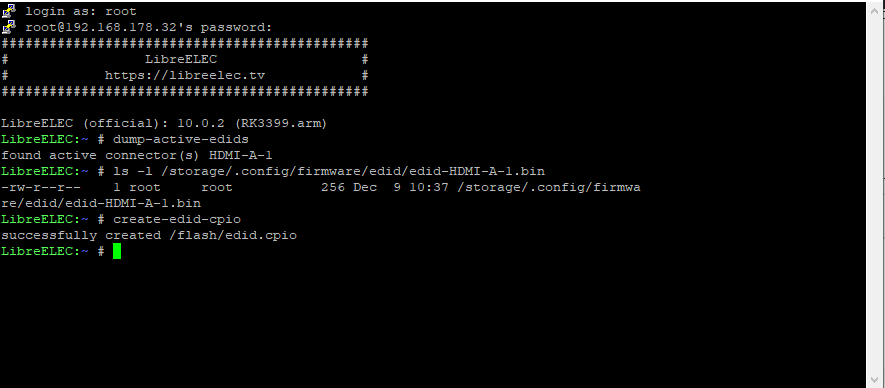

I am so far as seen in the picture.
What do now with this line:
I do not understand yet.
And on my rock 4 exists this file:
/flash/extlinux/extlinux.conf
With this content:
CodeLABEL LibreELEC LINUX /KERNEL FDT /rk3399-rock-pi-4b.dtb APPEND boot=UUID=0503-4902 disk=UUID=8ff85d86-0886-4367-affc-e7e92877481a quiet console=uart8250,mmio32,0xff1a0000 console=tty0 coherent_pool=2M cec.debounce_ms=5000
What should I do now?
Excuse my cluelessness <:(

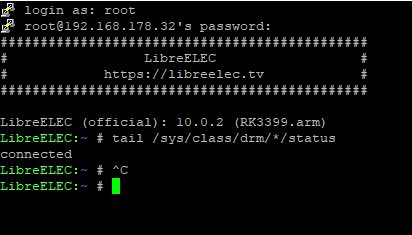

I have physically connected a Hdmi cable on the running TV
Should not be a Hdmi connector / driver to see?
login as: root
root@192.168.178.32's password:
# LibreELEC #
LibreELEC (official): 10.0.2 (RK3399.arm)
LibreELEC:~ # tail /sys/class/drm/*/status
connected
LibreELEC:~ #
