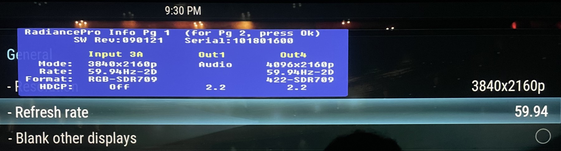

    BTW: also make sure you are using HDMI0 (the one next to the power connector on RPi4) - HDMI1 only supports up to 4kp30.
    so long,
    Hias

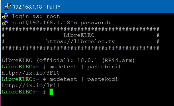

    Sigh, wrong HDMI port :blush:. I thought that my version of the Argon ONE M.2 case kept the HDMI ports in the same order as the Pi board, but it does not. It turns out port zero is the one further from the USB slots on this case. I had to check the PCB traces to be sure.
    http://ix.io/3F10
    http://ix.io/3F13
    These look correct.
    All is good now except for the fact that's it's still RGB. But honestly I use 60Hz very rarely on Kodi so whatever. I'm much more keen to get YCbCr 422 support:
    * I don't plan on running the GUI at 4K60Hz, I just wanted to test it. I'll switch the GUI back to 1080P60Hz and just whitelist 4K@60Hz for auto switching as needed.
    I switched the GUI back to 1080p and then whitelisted 4k@60Hz. I played Billy Lynn's Long Halftime Walk and Kodi switched to [email protected] as expected.
