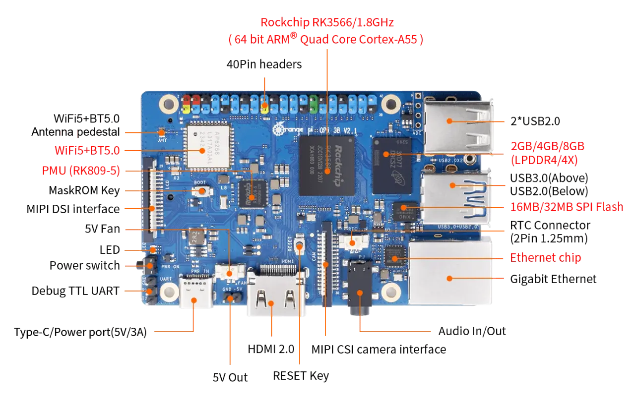

Display MoreGood evening After several days of using this board, I want to add the things that DON'T work: - The Wi-Fi and Ethernet aren't working. So I opted for a USB Wi-Fi antenna or an Ethernet hub connected to the USB 3.0 port. This solved the Wi-Fi problem. - Bluetooth doesn't work either, but that's not something I really care about. - Hardware acceleration isn't working, and I have to turn it off for smooth playback. This fixes the problem. I will be commenting on more things that I find, but at least I can use the plate as a multimedia center, which is the use I wanted to give it. Again, a thousand thanks to those who have made it possible for this board to slowly become functional and be able to use it without problems. Now we can say that there is an image for the Orange pi 3b. bye
Display MoreGood afternoon. I finally found this version: LibreELEC-ARMv8.aarch64-13.0-devel-20250512135332-e5590fa-rk3566.img You need to edit the extlinux file, renaming it FDT /dtb/rockchip/rk3566-orangepi-3b-v1.1.dtb, and it will boot without any problems. I also noticed that a DTB file for this board already exists in the "dtb" folder. It's for both the first and second versions. In my case, it's the first version, which is why the DTB file was renamed to v1.1. Now we just need to start testing what works and what doesn't, but what I can say is that everything starts up and works fine at first glance. I'll be posting the bugs so anyone can fix them if they're interested. Many thanks to the developer(s) who made this possible. I don't know if it's balbes150's fault or if there were other people involved, but thank you so much for making this board testable.

On the Internet, from the page http://www.orangepi.org/html/hardWare/…ange-Pi-3B.html you can see all its features.
