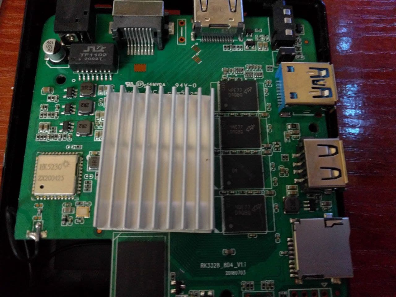

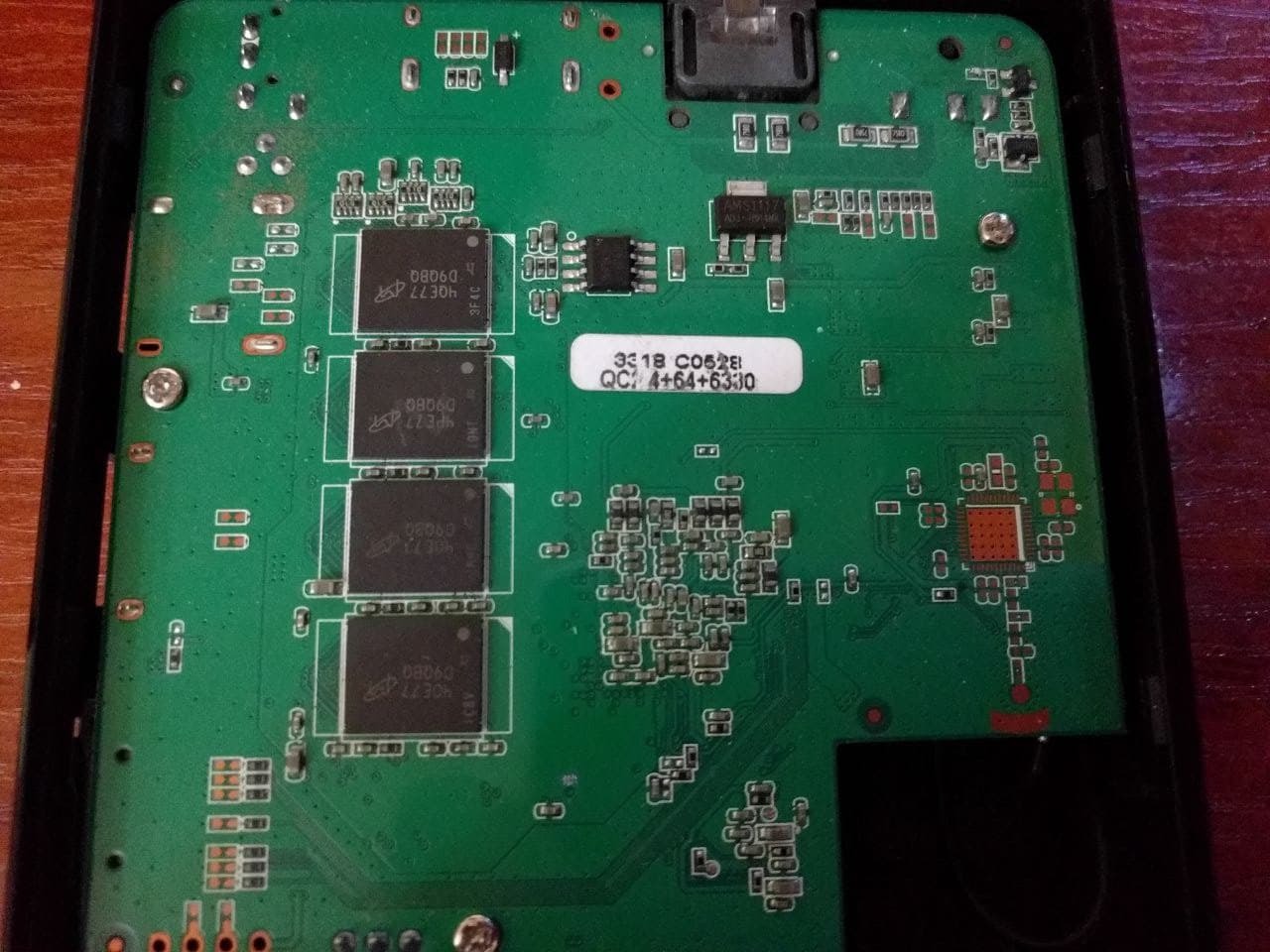

    Bluetooth --- NO. (I ask for your help to fix this and I am attaching a new log and dmesg. Pictures of the hardware can be seen in my previous post).
    Installing Libreelec in internal memory makes the tvbox brick, I would like to fix that.
    I wonder if with this data they can support this RK3318 (HK1 Super) tvbox or add the DTB and WIFI / Bluetooth driver to future images.

    WIFI or Bluetooth --- NO. (Attached log and dmesg. I also attach photos of the hardware).
    Installing Libreelec in internal memory makes the tvbox brick. With Multitool, Armbian and bridge on the board it is easily unbrickeable. I haven't tried this yet: https://forum.libreelec.tv/user-post-list/27218-jps1x2/
