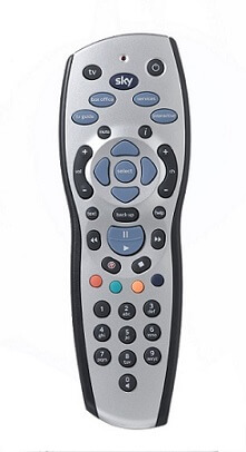

Sky+ HD Remote
it needs the timing adjusting otherwise you get double clicks,this is achieved with
