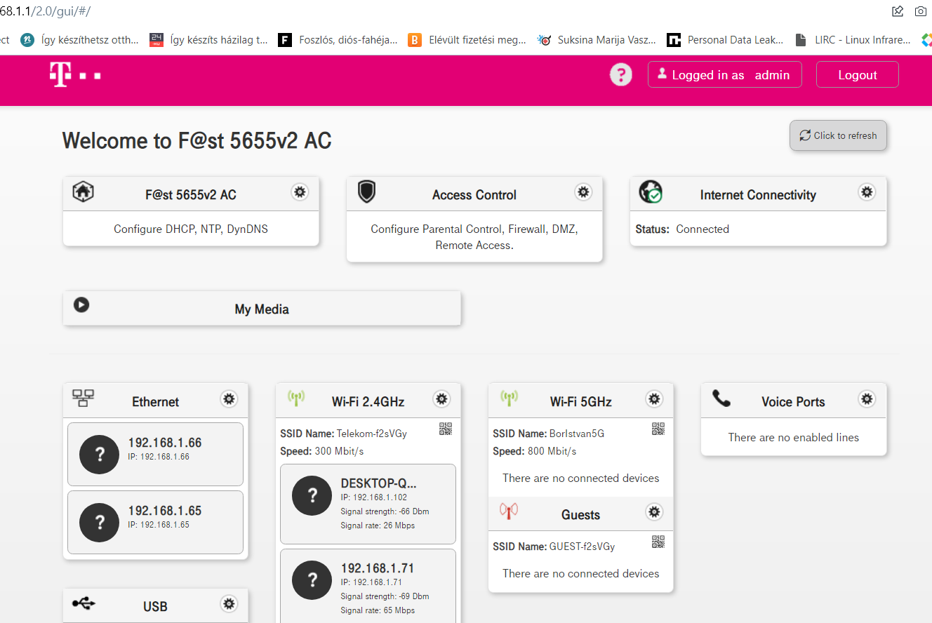

I solved it like this:
Router setting: another username and password for 2.4 Ghz and another for 5 Ghz. When you connect to PI4, you enter your 5 Ghz username and password, and you forget about 2.4 Ghz. Provided your routered allows it. Probably yes.
