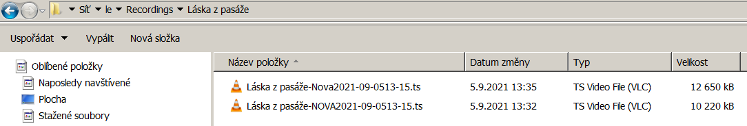

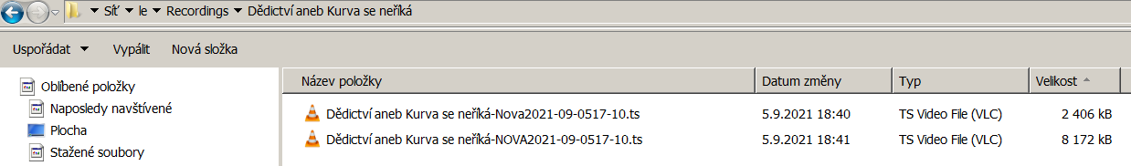

But, overall, I think Samba should be still able to serve the both files properly (even with the default name mangling configuration).
I don't know how the SMB protocol works but it looks Samba is able to recognize which file Windows client requests (as it returns a correct file length when Windows offers replacing the file yet existing with the same filename) but the wrong file (with the different file length than reported) is then sent... I'll try to look at smb.conf to understand better why it works this way.
Yeah, thanks a lot for the opinion, I think you are absolutely right.
I agree TVH should be configured better to save always a unique file names but currently I also don't know how exactly.
As in this case the recordings were made from different TV channels (different TV providers, transmitting the same program), enabling the TVH settings Make subdirectories per channel: could perhaps help.
As it looks there's no Samba / filesystem issue, let's mark this thread as Resolved. Thanks again for your quick help, I have learned something... The only confusing thing is the file size reported properly...
A good point... So on LE's filesystem it's OK.
It looks I am able to download only the files with eaerlier timestamp.
For Windows the filenames are the same. The replacement of the first file is offered when I try to download the second file and the correct filename size is reported. It does not matter if I allow the replacement or filename change instead, still the first file is saved.
