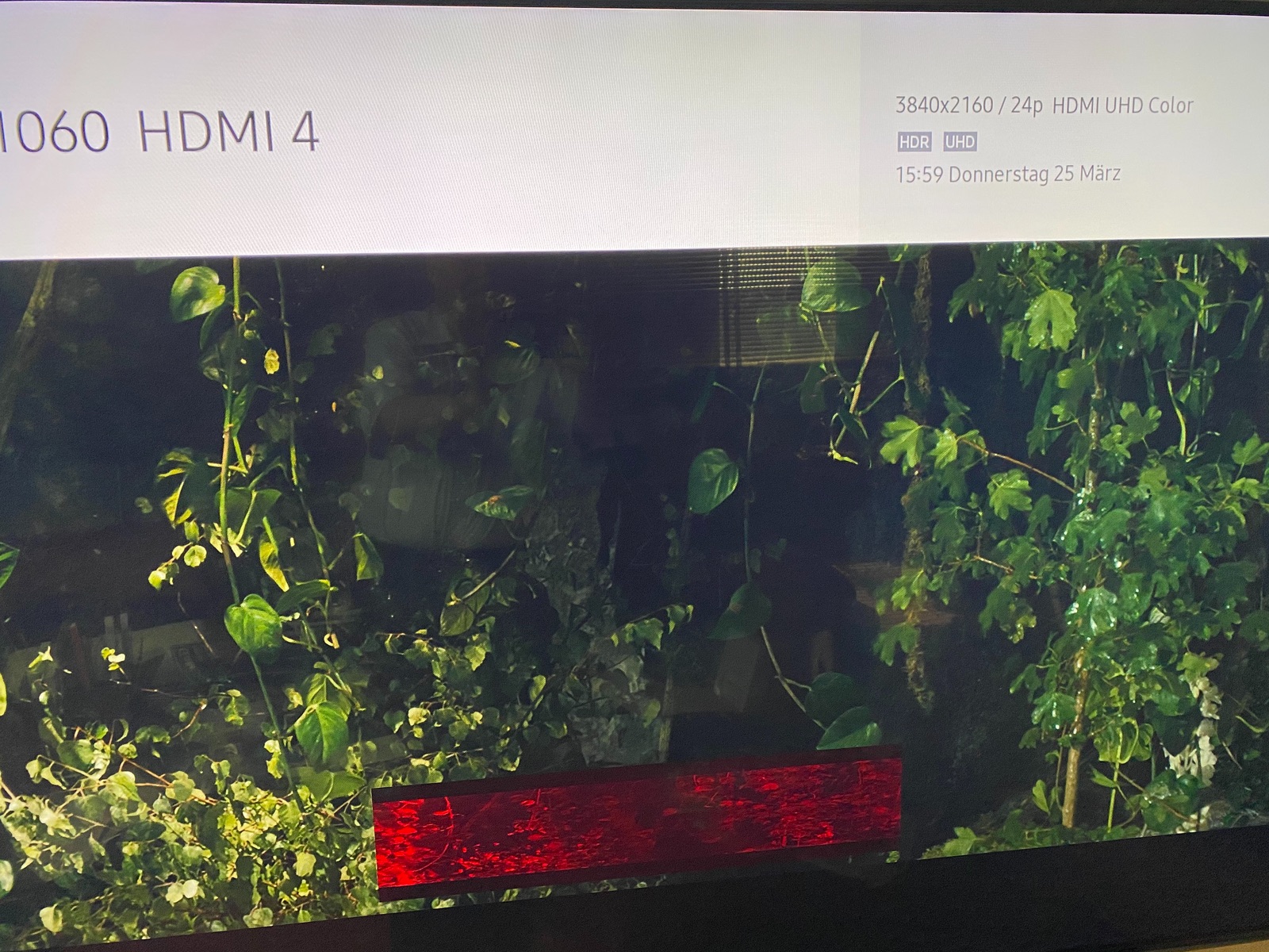

I also ran some tests on my NUC8i5BEH with the test version from post #502.
My TV reports that it receives an HDR signal. That’s the good part.
But at the location on the screen where the subtitles should be, is a bar which contains a stretched version of the running movie but only the red portion. Looks kinda weird.
