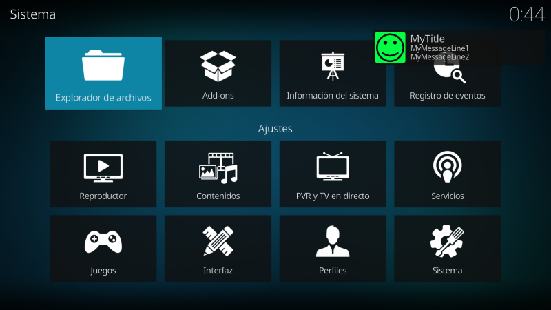

    Just in case that could be helpful to anyone stumbling upon this post.
    This code shown below worked in kodi 18.2 and before, and sort of still works with current kodi versions if the message is a single line.
    Also, long ago there was an attempt to allow base64 encoded images but it seems that was abandoned and so only the pre-defined keywords or files stored in some path that kodi can access can be used.
    Don't forget to enable the remote control options.
