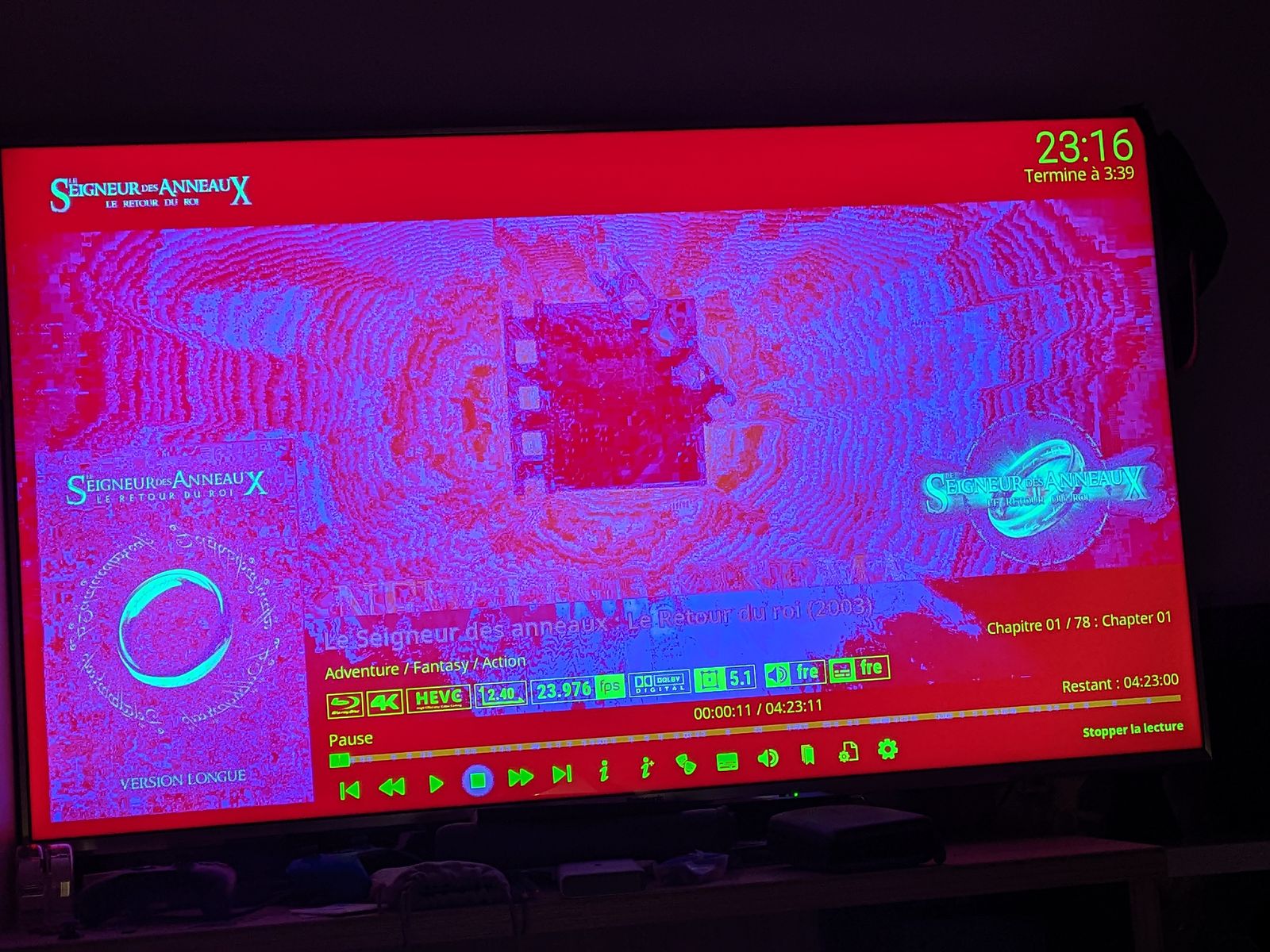

    Hi,
    I just installed libreElec. On some files, the video looks like this :
    I have no idea why it looks like this. I though it could be related to the HEVC encoding, but some HEVC files play perfectly fine and some look like this. The whole UI is like this too, it's not only the movie behind it.
    What could be the cause ? What should I do ?
    Thanks in advance for any answer, have a great day
    EDIT : I am not 100% sure, but it seems to be related to yuv420p10le colors. I noticed the problem on other files that are encoded this way. Is there a way to play them ? Maybe by changing player settings ? I have a lot of files encoded this way.
