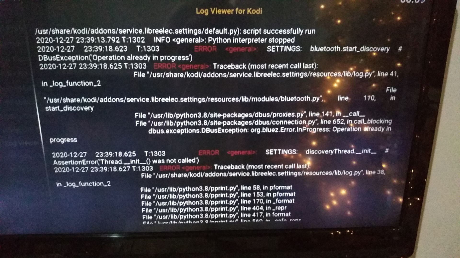

Andre Bollo BT in the GUI is managed by the LE settings add-on which is in the process of being rewritten for Python3; and BT is still one of the bits that's being worked on. If you SSH into the OS you can use "bluetoothctl" to pair devices etc. - until the GUI work is completed.
thanks. With bluetoothctl I managed to connect the devices. Looking for information about bluetoothctl I found that some adapters wait for pairing only for 3 minutes after they stop working, this helped me a lot.
i have an opipc with a bluetooth adapter, after upgrading to kodi 19 i can no longer connect my bluetooth devices. They appeared on the configuration screen, but did not connect, after the last update they do not appear anymore. Is anyone else with this problem? The bluetooth adapter is 2.0, is that the reason? -
