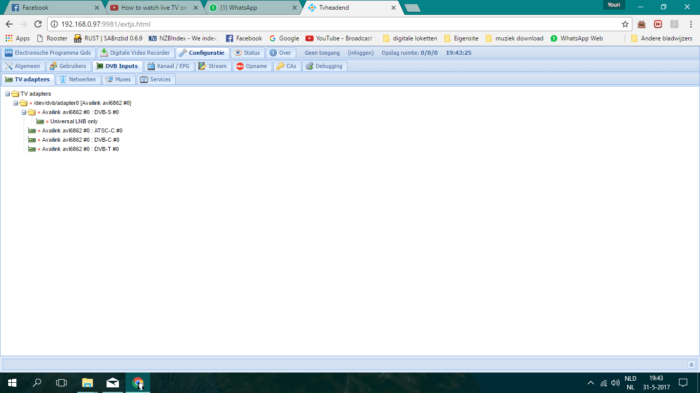

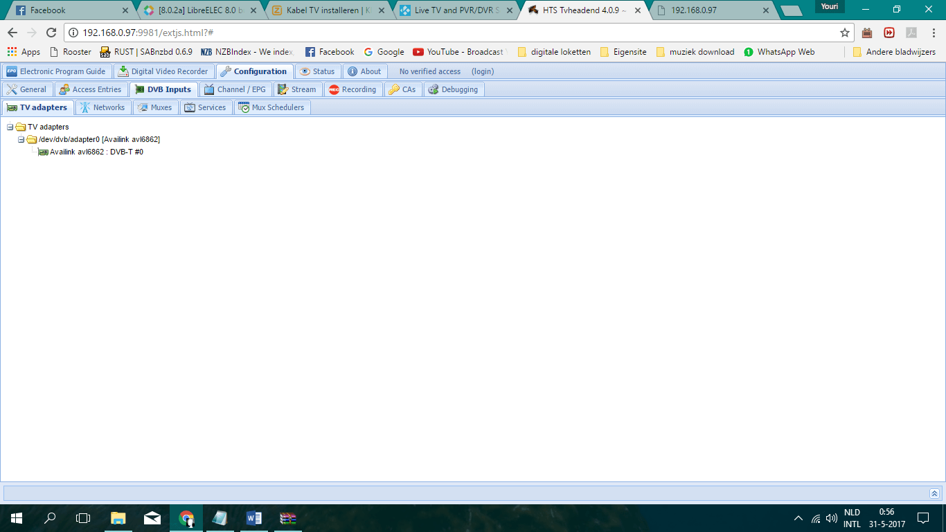

I can select DVB-C within the android DTV app, but when i search for channels it won't find any (ziggo/ the netherlands)
Maybe i'm doing something wrong?
