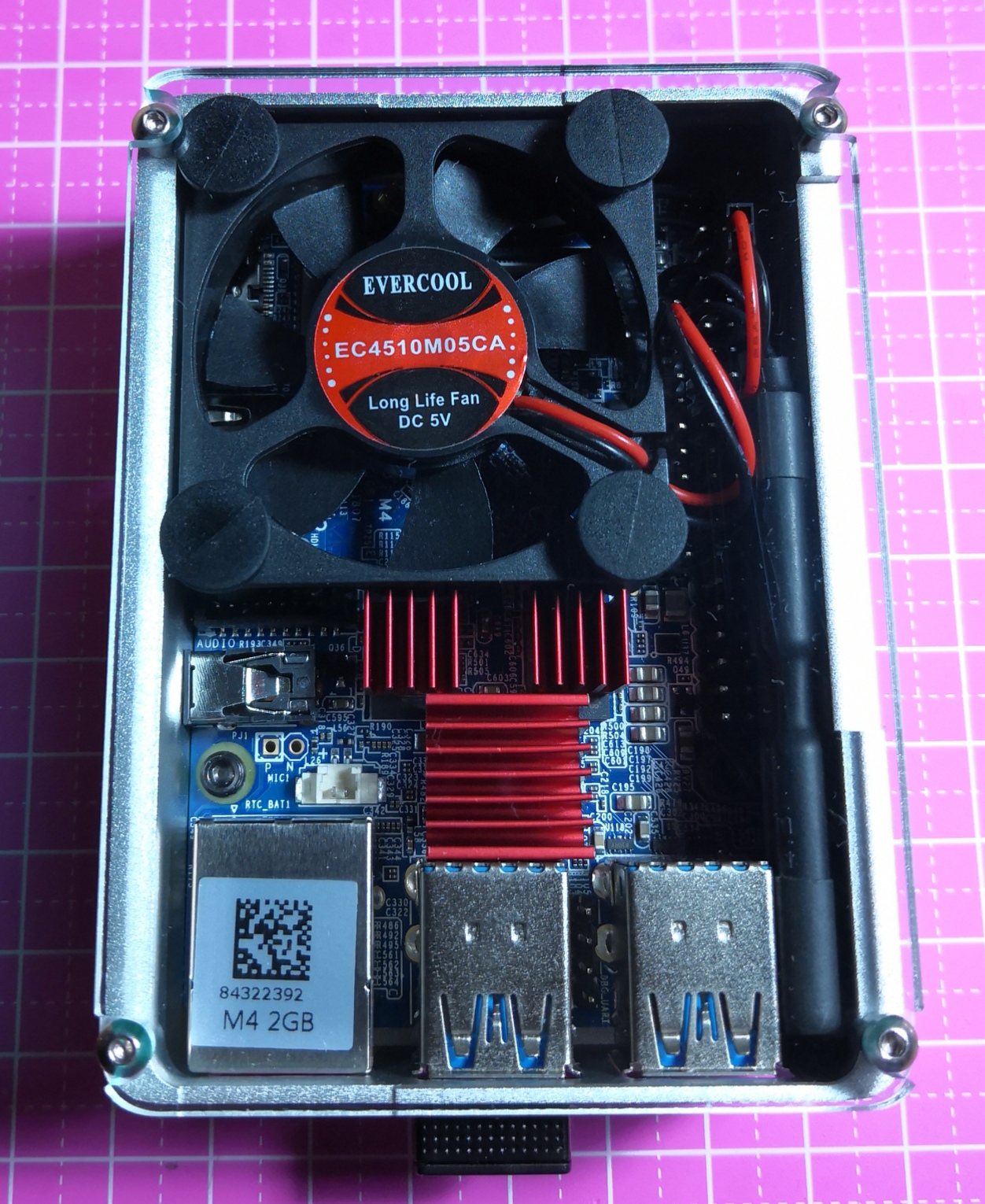

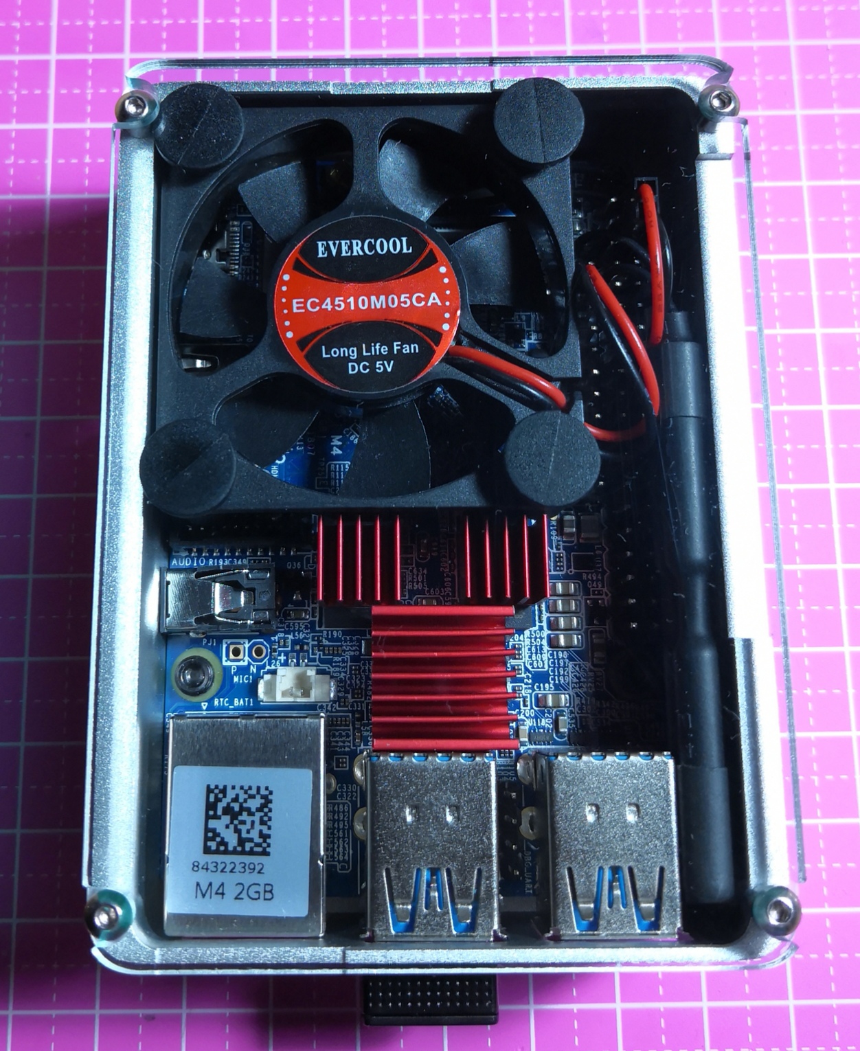

    I hope you are all enjoying your Nano Pi's. Here is an update on my hardware. Nothing more has changed from my past post except that instead of a 40mm 12v fan, I ordered a 45mm 5v fan. This draws the temps out a tab better. I also ordered 2.6mm aluminum spacers to raise the top to allow the hot air escape. Great little setup! Have a great evening!

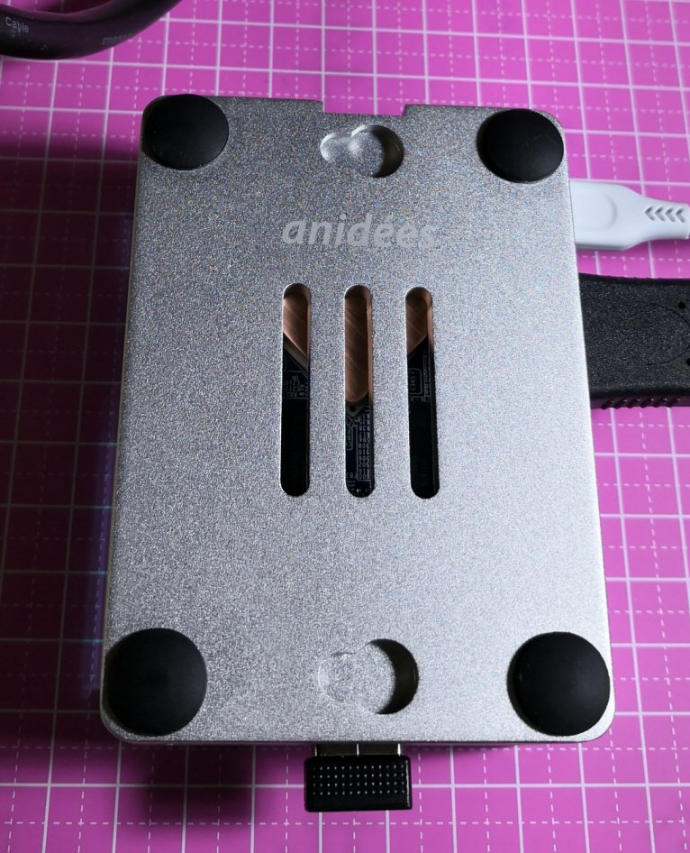

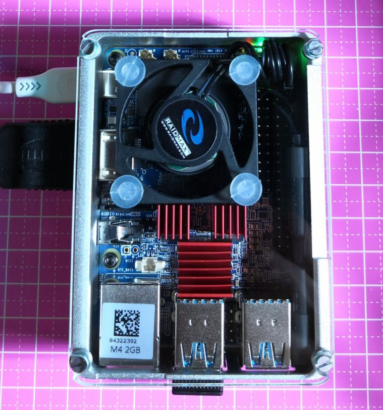

    For everyone else, here is my NanoPi M4 happy in an aluminum anidees case. I like it a lot, unlike the one recommended as it's open with no protection. The anidees is VERY well made and fits it perfectly. I just needed to make it work but it was easy.
    What I did/used:
    1. 3 pure copper plates on top of the processor with thermo tape and thermo tape on the inside bottom of the case so the CPU is using the case as a heat-sink just like the Flirc.
    2. 12v fan right on top of the board to get the temps even lower and the temps after 3 hours of running never go above 135 F. I've seen 140 F spikes but they go back down to 135 F under a minute.
    3. Added 2.5 mm aluminum spacers under each screw on the top acrylic top to allow the hot air to escape.
    4. Raspberry Pi heat-sinks on the memory chips and the USB 3.0 chip. Not sure if they are needed but I added them.
    5. Using a Rii remote also to control everything-works perfectly.
    I think the NanoPi M4 is happy in the case. I really like this board!
