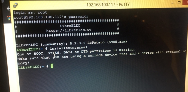

Hi, someone can tell me how this error is repaired. in mecool ms8 pro w
installtointernal does not work. how to correct it
