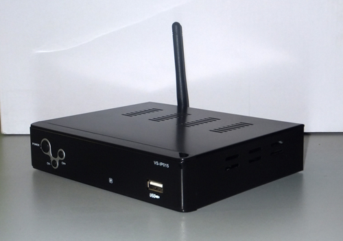

[9.X-devel] LibreELEC builds for G02ref (Prima PM-6001, VS-IP166, VS-IP015, ...)
easy update via ssh:
Display Moreemanuel@xanadu:~$ ssh [email protected] [email protected]'s password: ############################################## # LibreELEC # # https://libreelec.tv # ############################################## LibreELEC (community): devel-20190106124554-df9076a (Amlogic_G02REF.arm) LibreELEC:~ # cd .update LibreELEC:~/.update # wget -O update.tar http://download.blue-panel.com/krogoth/kodi-18/developer/aml8726_MX/LibreELEC-Amlogic_G02REF.arm-9.0-devel-20190106221300-df9076a.tar Connecting to download.blue-panel.com (31.47.234.114:80) update.tar 100% |***************************************************************************| 118M 0:00:00 ETA LibreELEC:~/.update # reboot LibreELEC:~/.update # -
This is a LibreELEC build for g02ref/g18ref_th2 devices (Prima PM-6001, VS-IP166, VS-IP015, or other similar MX boxes)
with Amlogic AML8726-MX/M6 SoC (Amlogic Meson6).
It is based on current LibreELEC WeTek Play build and my code port for g02ref.
It is using the WeTek Play LibreELEC Addons repository so you should be able to install binary addons from the official repository.

It is a sdcard boot image, so you can just use the LibreELEC usb-sd creator to flash your card.
so old bricked boxes can also be used for it
Download (updated 03 04 2019):
LibreELEC-Amlogic_G02REF.arm-9.0-devel-20190106124554-df9076a.img.gz
LibreELEC-Amlogic_G02REF.arm-9.0-devel-20190106221300-df9076a.img.gz
Release img
LibreELEC-Amlogic_G02REF.arm-9.0-devel-20190307225115-0e98e15.img.gz
Addon VFD (Prima PM-6001, VS-IP166)

Supported devices:
It is tested on VS-IP166 (videostrong)/Prima PM-6001. If your device has different remote try connecting USB keyboard.
usbboot:
flash the image on a usb stick/hdd and copy the aml_autoscript from the first usb partition (FAT) to a sdcard (FAT) using common winpc.
Plug in usb (port 1, rigth one on in my case) and sdcard, box will now load the image from usb port 1.
Have fun
