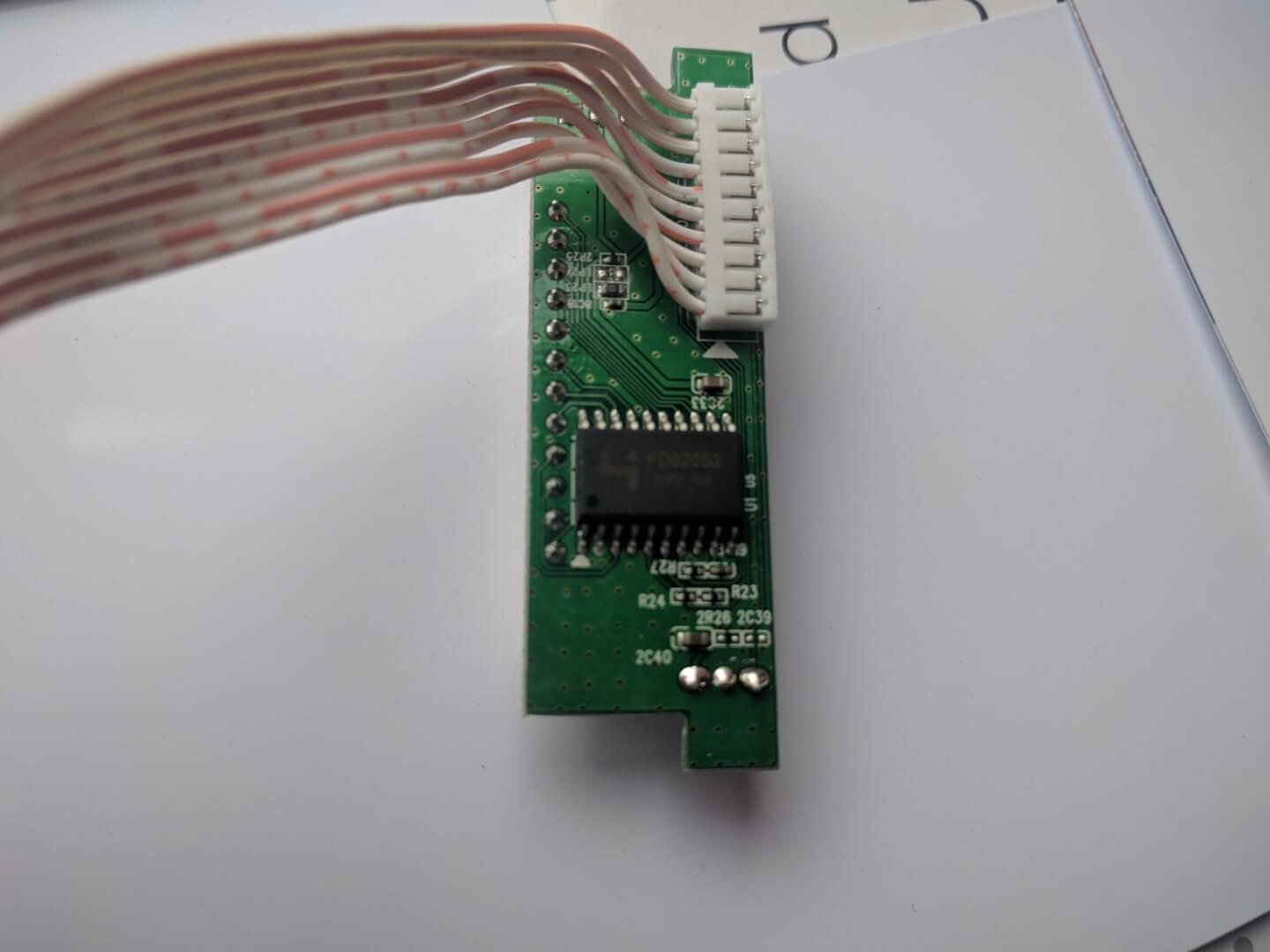

    New driver did the trick for T95U Pro here is the test video.
    External Content youtu.be
    And your settings were spot on
    Display Type = 0
    Common Anode = unchecked.
    Index 0 is 4
    Index 1 is 0
    Index 2 is 1
    Index 3 is 2
    Index 4 is 3
    You really are the coolest 😉 thanks for your help.
