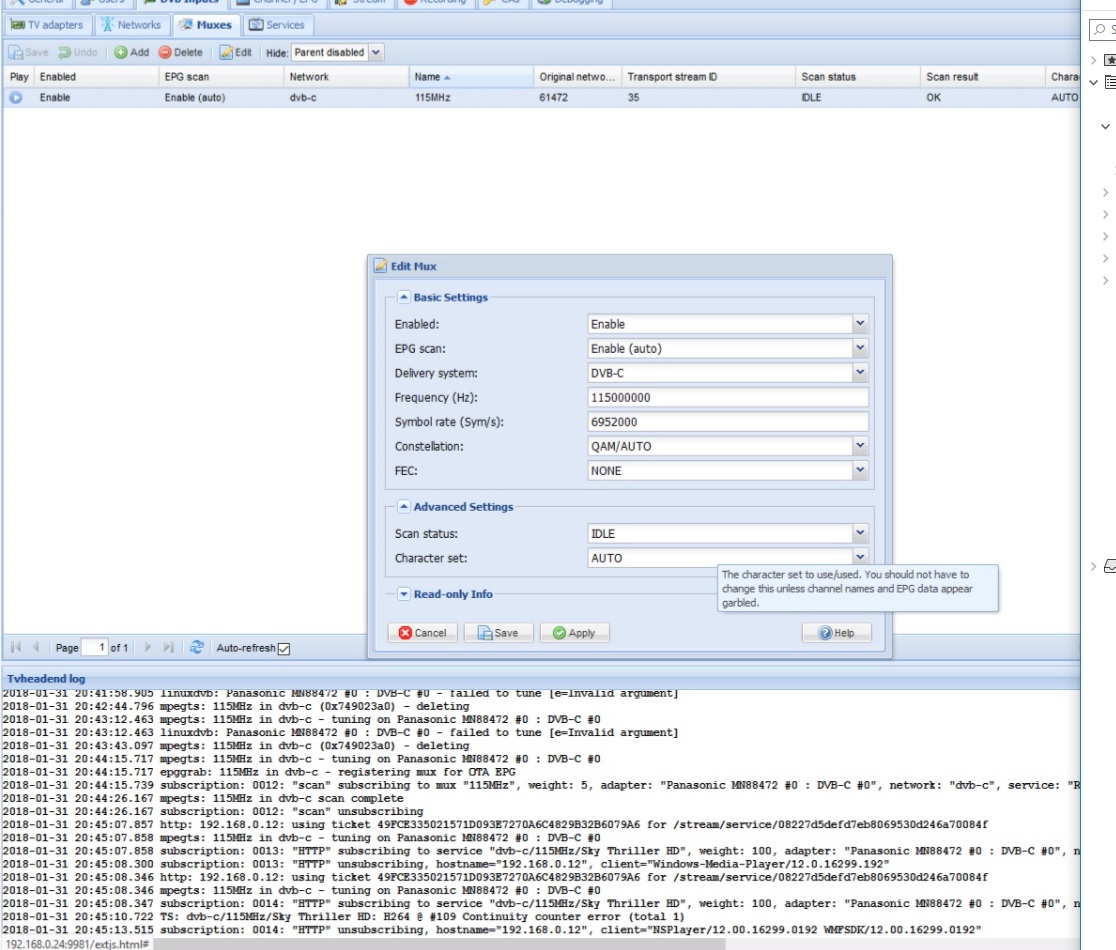

    well im going to continue with fresh channel scan / install .... then in muxs > epg scan tab > set all muxs to disable instead of Enable (auto) as above picture then try webgrab plus again. I cant think of anything else to try at the moment.
    Ive spent hours on this lol but dont like to be beaten ;p
    Also just noticed on dvb inputs basic settings i have Over the Air EPG ticked which im going to untick on new scan

    im running the one included from the libreelec repo in services , i just thought id try again with a clean slate new memory card see if i missed something i noticed on mux i have enable (auto) on and as result when its scanning its registering mux for ota epg , im thinking this might be a issue or ?
    Ive included picture again ...

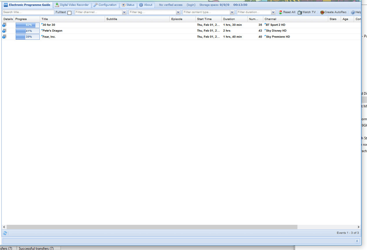

    when tv headend runs the grab file it displays as in picture attached

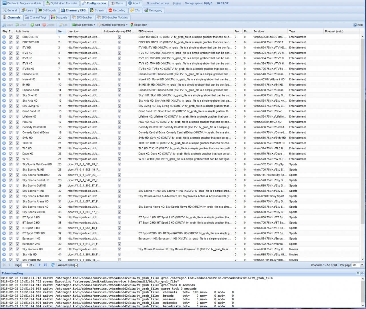

    this line you suggested :-
    /storage/.kodi/addons/service.tvheadend42/tv_grab_file
    i ran this via putty and i could display all the epg stuff , small example :-

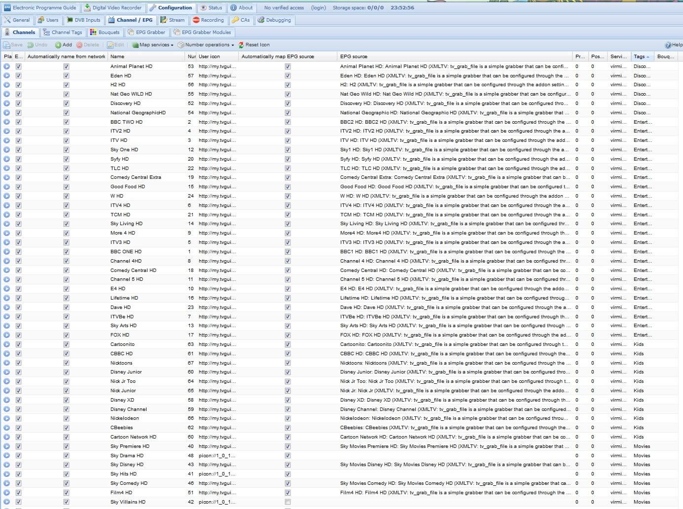

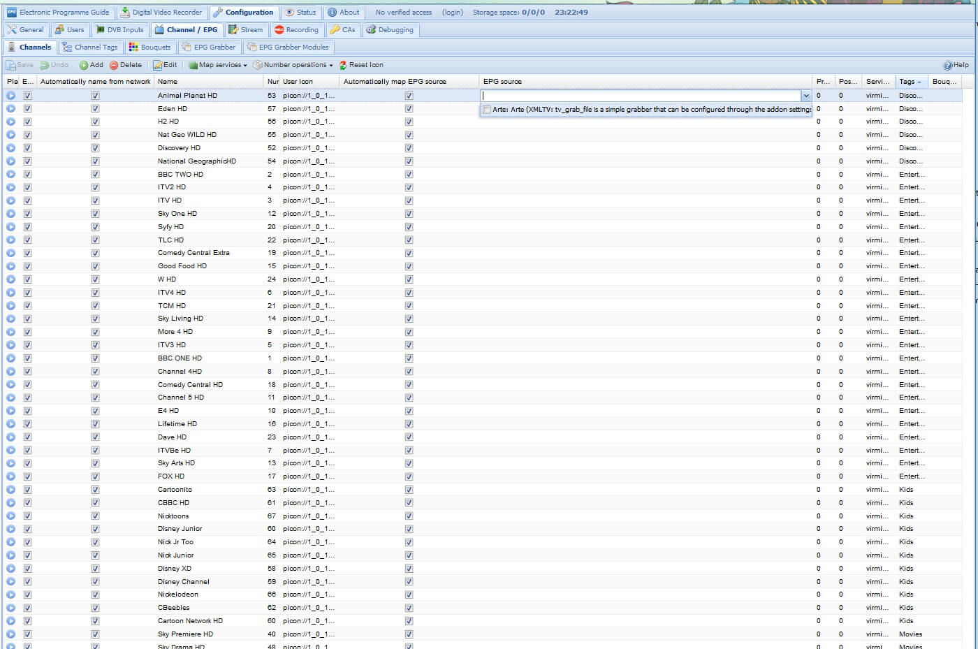

    So after much head bashing i followed this created guide.xml using site .ini pack for tvguide uk on windows copied to
    /storage/.kodi/userdata/addon_data/service.webgrabplus/guide.xml
    I then went to configuration in tvheadend channel / epg enabled Internal XMLTV then i goto channel list and for epg source select XMLTV but mine is displaying as including in picture ie arte (XMLTV , would really appreciate some help please ... banging head of wall for hours now lol
    finally , sorted :D

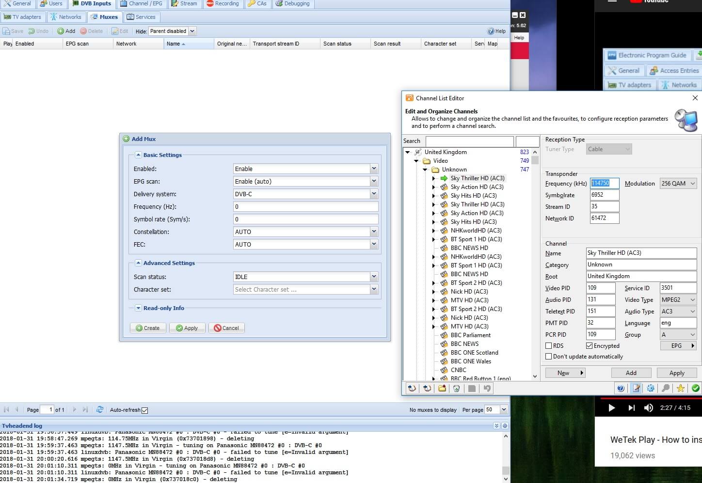

    could really do with some help I purchased the Xbox one tuner and tried to tune channels for dvb-c virgin ive tried all combinations and cannot get this to even scan am I missing something ?
    included picture of error and values ive tried just added frequency and I constantly get :-
    e=invalid argument
    noticed the Xbox tuner has the same tuner as the astrometa I was having trouble tuning also i.e. MM88472 Panasonic I bought the Xbox tuner because I thought it worked but maybe im missing something any help greatly appreciated please ......
