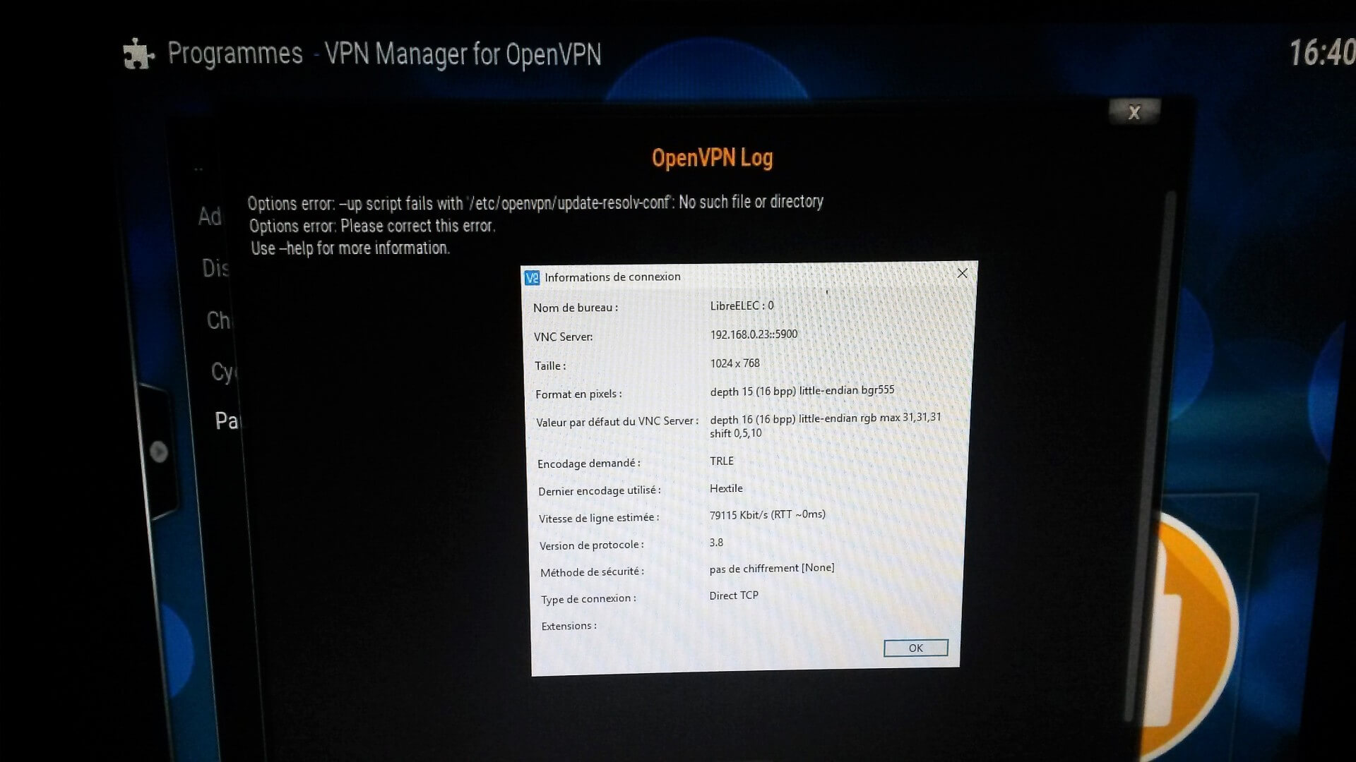

    I filled in the VPN Manager for openvpn console: username, password, UDP etc
    then I launched the wizard of the first vpn and I managed to load the files.vpn of the protonvpn provider
    and after I tried to activate the first vpn and at the end of the activation the error message appears

    et après l'installation de la configuration et de connexion zomboided le fichier journal indique que le chemin etc / openvpn / update-resolv-conf ne peut pas être trouvé
