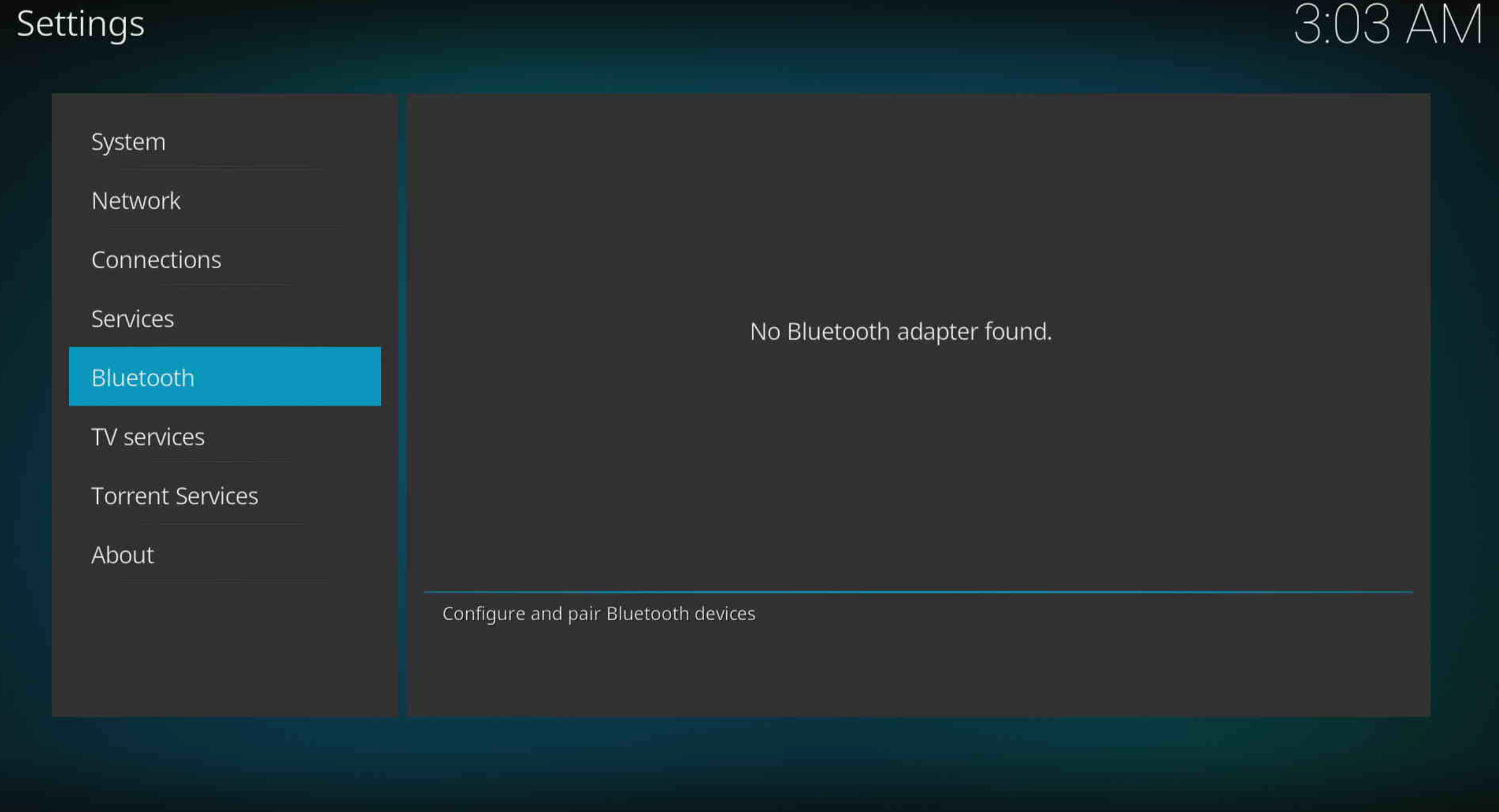

    Thanks for the response! Unfortunately none of these builds work with Bluetooth, including the MK808 build (My device is the Mk808BPlus)
    The following build compiles as "MXQ" and works perfectly with my device with Bluetooth and everything, but its an outdated version of Kodi (17): GitHub - kszaq/LibreELEC.tv at 8.2.3.1
    My goal is to get the latest version of Kodi running with the 8.2.3.1 kernel or fix the BT issue in AlexELEC - either would be great. Any help would be extremely appreciated. I would be willing to donate to fix the BT issue with the AlexElec build. I have a bunch (almost 100) of these MK808B+ sticks so fixing bluetooth has value to me. Just don't know who to go to for help with it.

    The loading of libaries and images takes significantly longer compared to the mk808b plus, but haven't had the device long enough to know if this is a hardware issue so with speed test the cards. I am also getting the odd freeze of around 10 seconds, this is on a class 10 micro sd card. It's currently not detecting bluetooth, despite me trying various times (works fine with a USB dongle).
