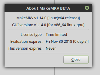

I use makemkv on my desktop (linuxmint) and it never stopped working, but i have the update function disabled.
Well IMHO this package is way diffrent of the Kodi addon since it's the libs that Kodi uses and probably not even the makemkv binary. Anyway if it needs a proper key one day I would have to drop the update script anyway ![]()
Well you are right that while it is in beta a key is not needed, but what about this statement on their website?
MakeMKV BETA has several major restrictions.
Program is time-limited -- it will stop functioning after 60 days. You can always download the latest version from makemkv.com that will reset the expiration date.
Probably because this key changes every two months... MakeMKV is free while in beta - www.makemkv.com otherwise I don't see how the program should know how long it's already in use. Or has MakeMKV stopped working for you?
Btw.... Can't get beta working? - www.makemkv.com since this question came up 6(!) years ago and they also refered to the beta key so... ![]()
Question about the makemkv addon
Suppose that i want to buy a key for makemkv would that be a problem with the key update code in your plugin?
Well as long as MakeMKV is a beta the key is not needed and once it's needed the key updater won't work anymore. So I could implement some function to read the key from a file but as I said it makes no sense right now. You can still buy the code to support the development of MakeMKV though.
