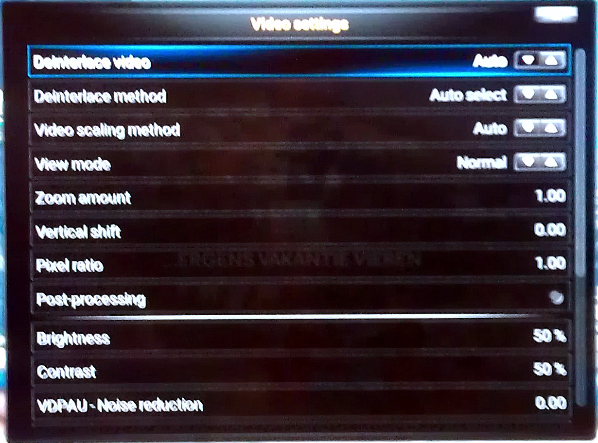

    I'm wondering, are there settings which can be adjusted on the amcodec? Such as deinterlace type, scaling method, and so on?

    If there would be some kind of deinterlacing, where would I find the settings in Kodi?

    Settings such as deinterlacing are accessable while playing video and then choosing "video settings" (see attachment, image from my x86 openelec htpc). I used to run "OpenELEC-Amlogic.arm-S82-6.0.0"

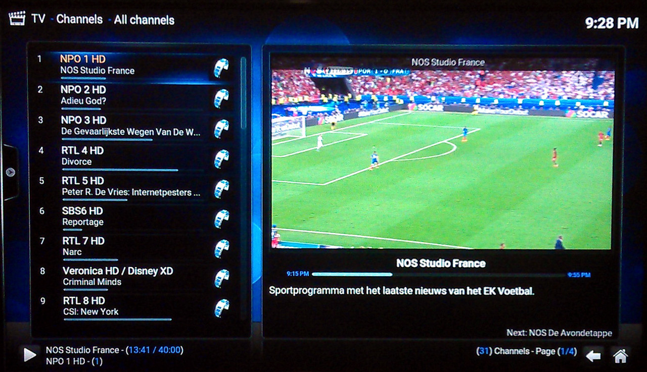

    My observations: pvr works fine, i'm using the dvblink plugin at this moment. I do not have the video settings which i am used to in the x86 version of libreelec. No deinterlacing of any kind. My mce remote doesnt work (it did in the build from amlinux.ru). When i turn off the device from within the menu it turns off my tv through CEC and the mxiii reboots.
