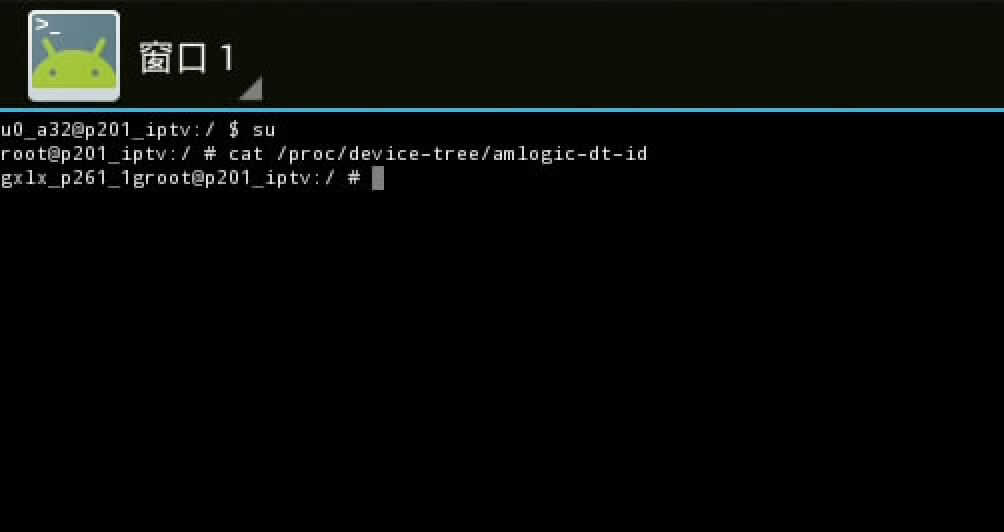

I have a new Android TV box and new dtb file from Android system.
it is gxlx_p261_1g.
