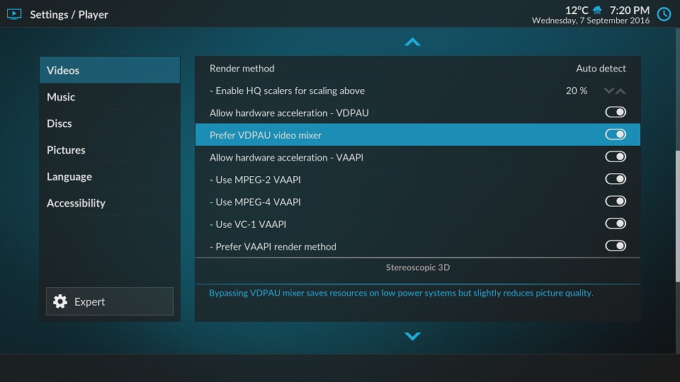

https://wiki.libreelec.tv/index.php?titl...de_LogfileHow about a screendump of your Video acceleration settings? Just press PrtScn, the image(s) will be in the screenshots folder.
Perhaps Kodi defaults to VDPAU acceleration (=Nvidia), instead of VAAPI (=Intel).
Log & shots attached...
Trying disable VDPAU,disable VAAPI , disable all. did not help
