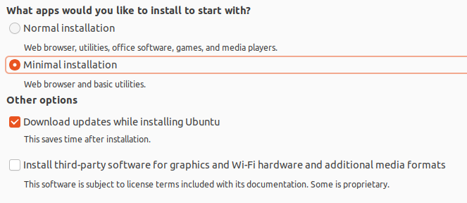

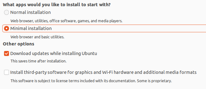

    Ubuntu minimial with openssh is all that's required; then you can SSH into the VM to install prerequisites and clone sources. There's no need for the GUI environment too, but I guess for some users Terminal access will be easier than SSH.

    Installing Ubuntu 22.04 on a virtual machine as build environment. Is suppose it is just a standard installation. Is there any need to install this:
    Will a minimal installation be ok? Think there is no need for all the fancy stuff.

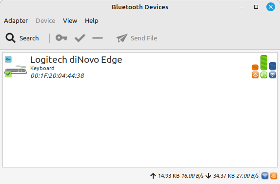

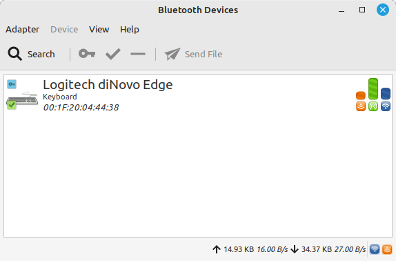

    Ok, after fresh module build when updating my Mint laptop to kernel 6.5.0-27-generic the keyboard is working again.
    So now I'm sure the keyboard itself is working.
    Details of bluez version installed on my laptop:
    So what can be the issue in LE? Bluez?
