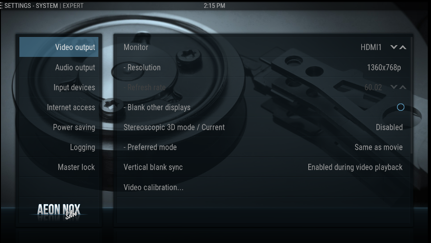

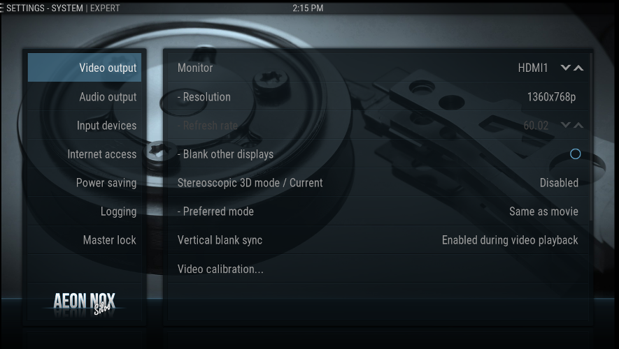

    BOOM! my over scan issue was back. I discovered that System-->Settings-->Videos-->Playback: Adjust display refresh rate: is off by default. If it's set to anything else, I got the overscan problem.

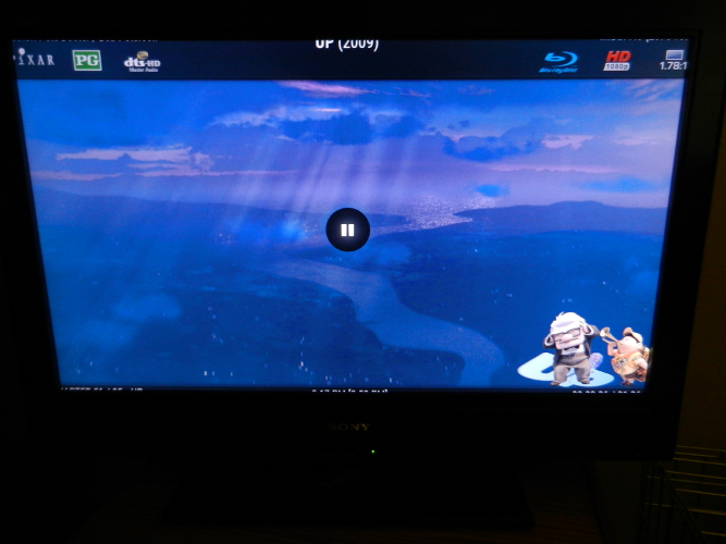

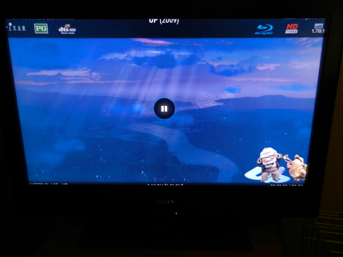

    I guess a better way to descibe it would be the picture over flows the TV's screen. The picture looks cropped, it's not the capture but how it actually looks on screen. On the bottom, the seek bar is almost completly hidden, and on the top movie information is also cropped.
