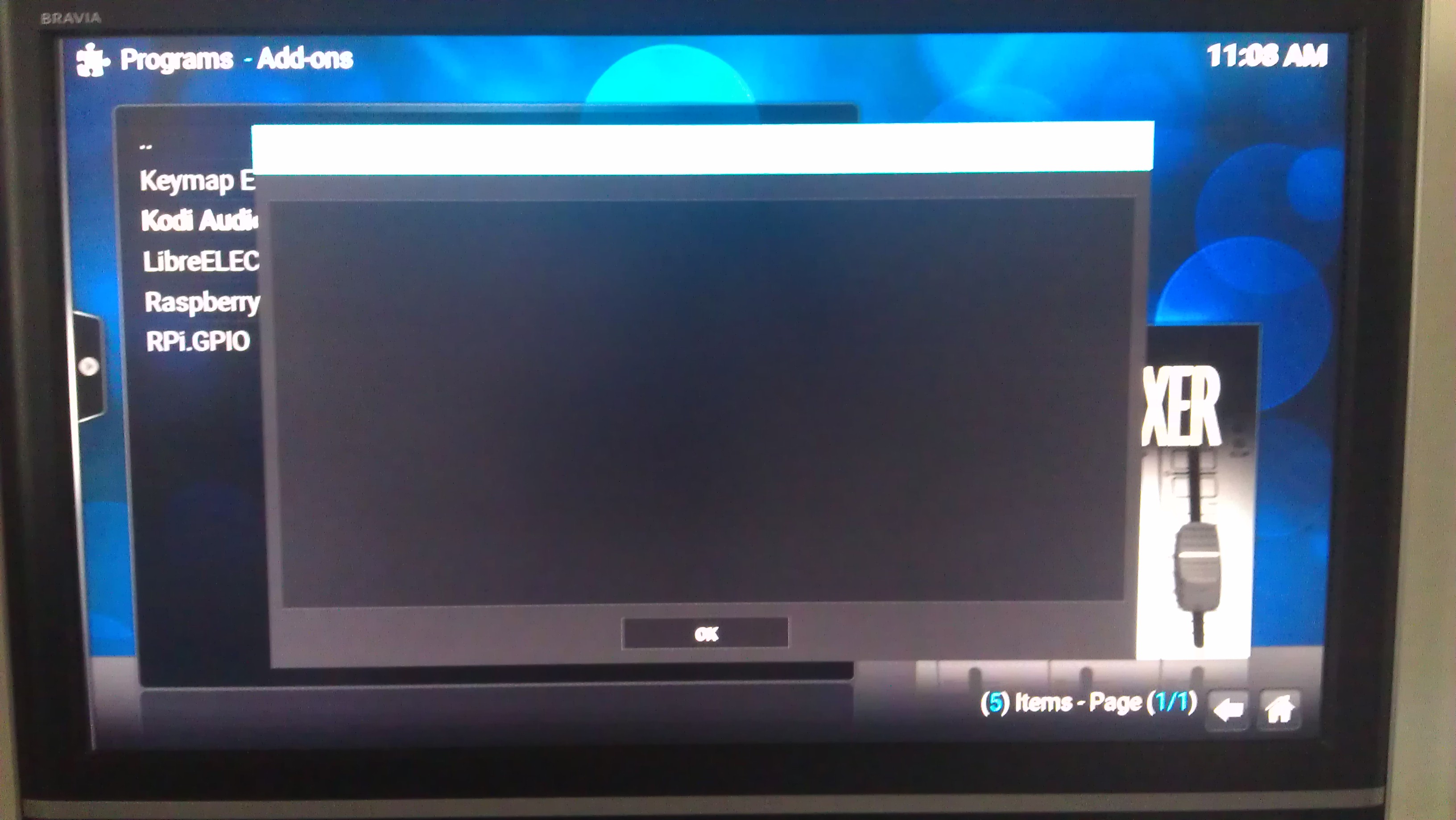

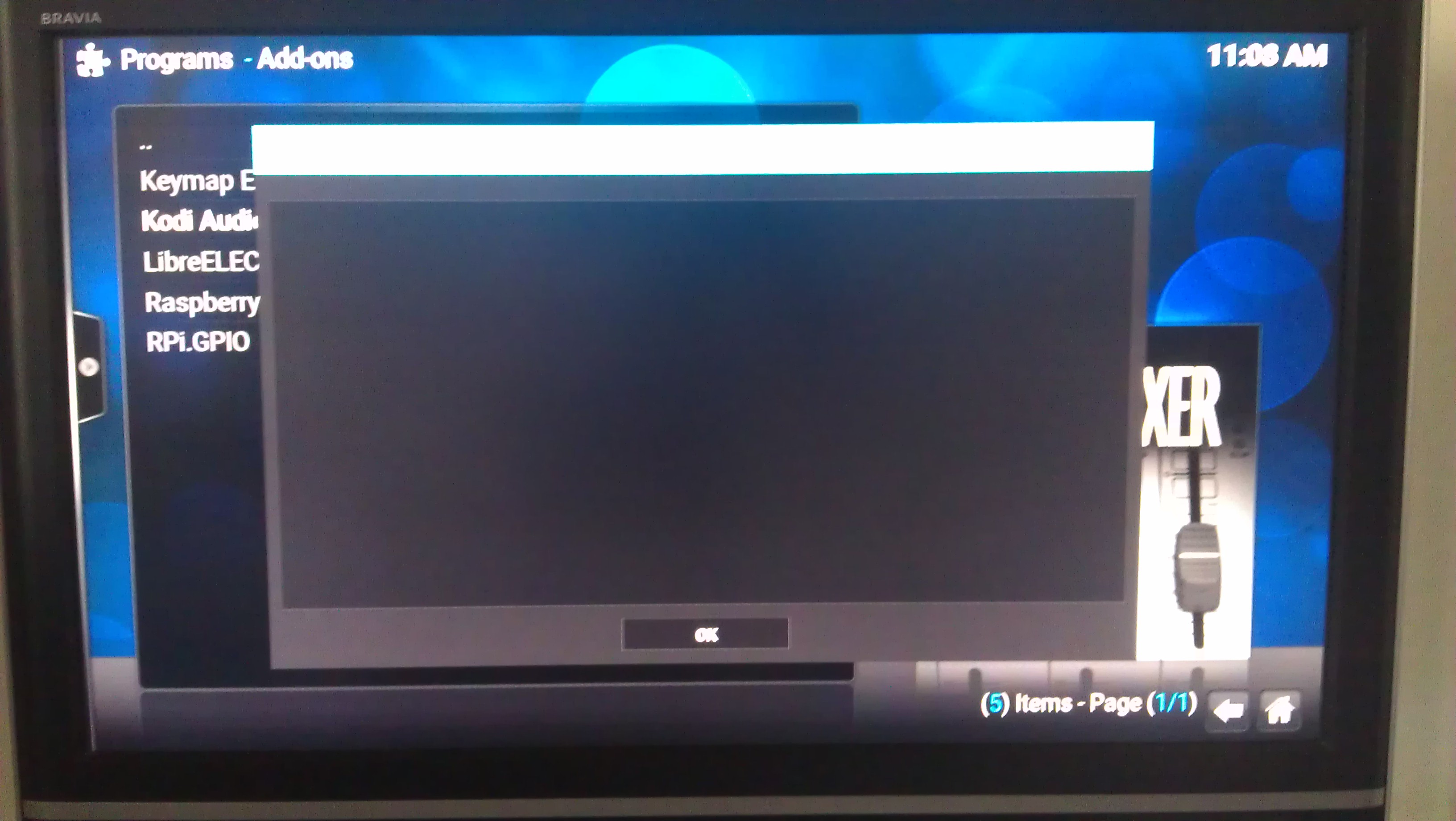

Hi, I have LibreELEC 7.90.008 installed on RPi3, and also I have installed Kodi Audio Mixer to control bass and treble amounts but there is nothing to change in its window! the mixer 's window is flat and empty (without any options). There is just "OK" button.
